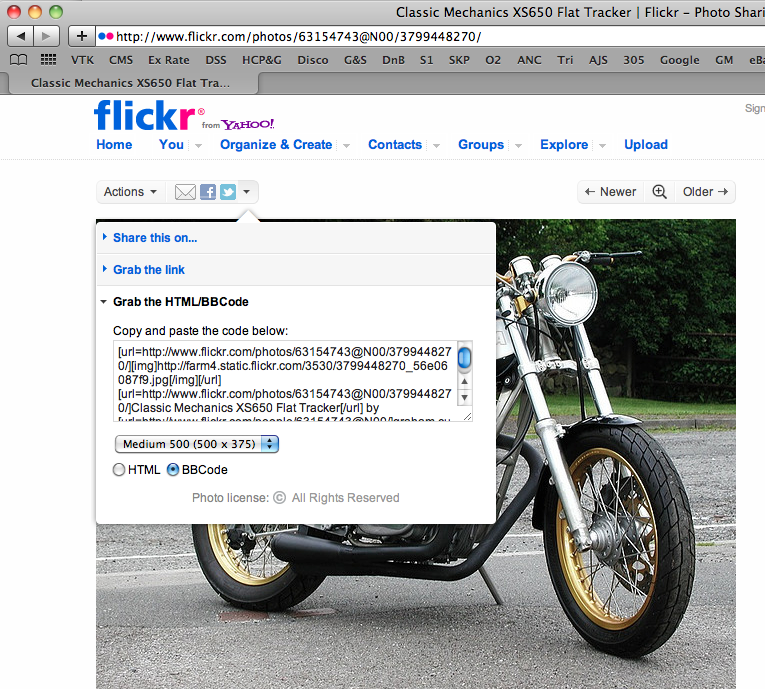

I have a number of pictures that I have been trying to load into a post for 2 hours. I can't get the pictures to load in the right order and can't cut and paste text to put things in the right sequence. Can anyone explain how I can get this done?
The patient is on life support awaiting your help.
Bill
Upload them to 'Flickr' http://www.flickr.com first and then you can just paste the links in your text in the right order.
Use the 'grab html / bbcode' option then paste it in your post.
