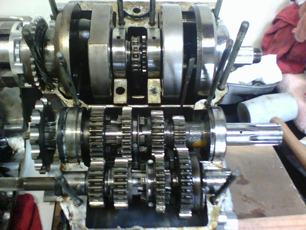

Well after talking to Ed this morning I split the cases... this was the first time I've done it on this engine and my first time ever... It went pretty smooth... now having it apart everything seems ok... but I don't have the trained eye... but I am able to move it through all of the gears I think... take a look at the pics and let me know what you think... I'll post the ones of the gear box that I took with my phone first and then of how the shifter fork was hitting weird tonight as those pics are on my camera and I don't have the cables at the shop.. Joe what adjuster do you mean? I don't think it was shifting properly before I started...

You may want to pull the shift drum out and see if there are any chips in it where the small rollers ride and check condition of rollers.Rollers sit in drum guides for shift forks then bolt goes in shift fork.If you have a parts book it will show this.Joe
