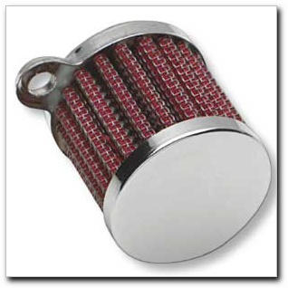

In terms of performance increases with the K&N filters, my seat-of-the-pants perception is that there is a noticeable tweak in performance, and it seems to be throughout the entire range. Mind you, we did also adjust the Amals, and I have the Toga exhaust system, so I think the addition of the filters rounds out this particular system nicely. The Amals may need a smaller main jet once the warmer weather sets in, but we'll deal with that easily if it's needed. And yes yes, the vent filters are officially installed on the bike, so no worries about potential 'raw' air contaminating the engine, though I'm still a bit of a Doubting Thomas about that likelihood. I should be picking the bike up next week from 'the masters' Bob Wolf and John Grainger of Wolf Cycles (the weather should be much more agreeable than the current 18 degrees farenheit) and I'll post photos of how they have been installed. John ended up using a pair of filters from Drag Specialties rather than the K&N's because their mounting bracket worked better for him, but they're basically the same type of filter.
This is the Drag Specialties mini crankcase vent filter.
