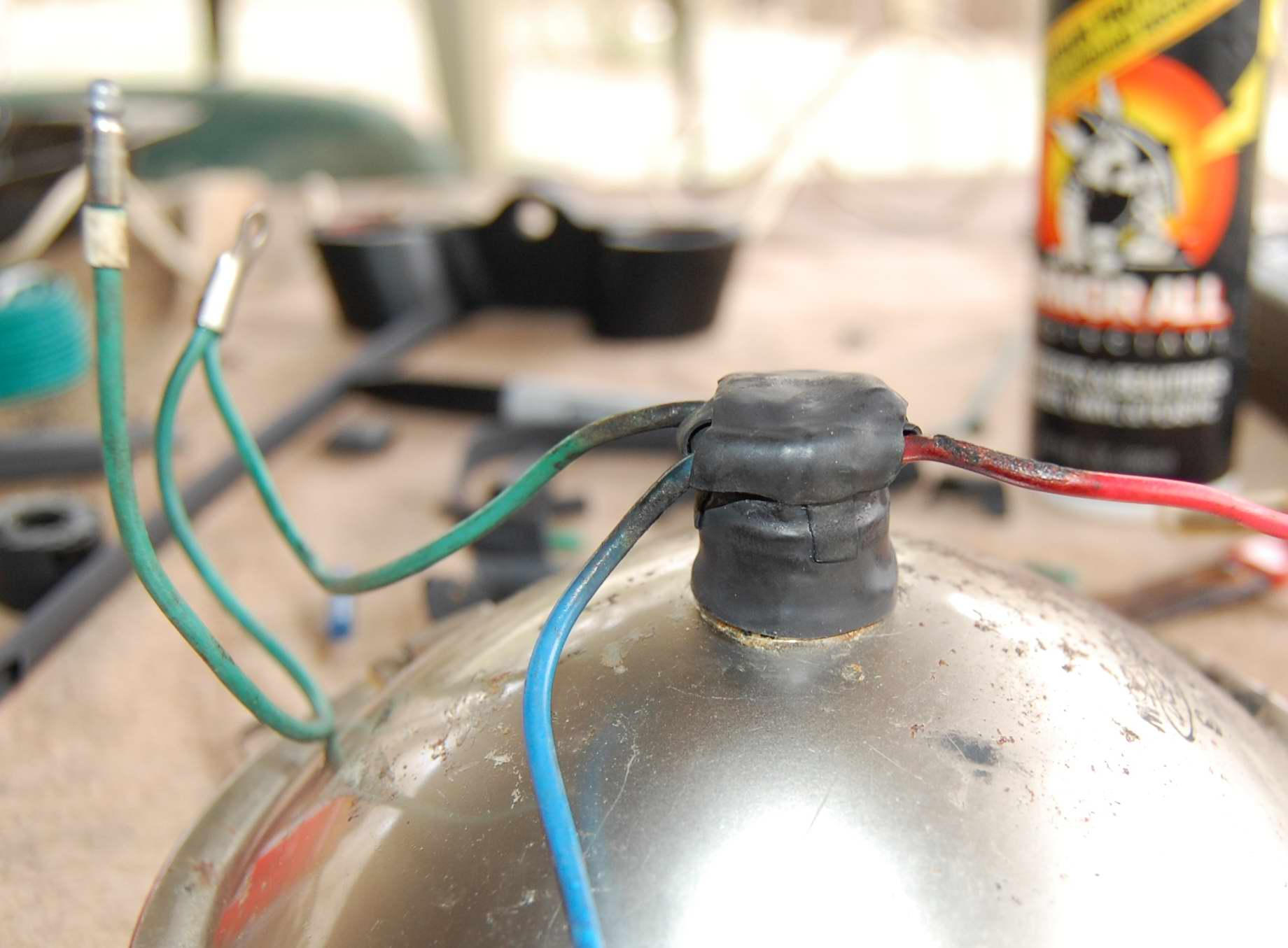

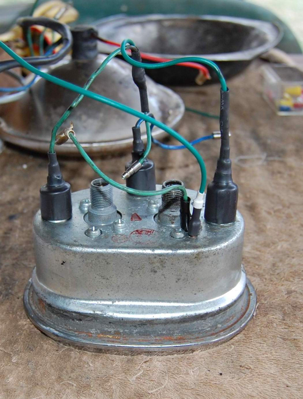

Boots, etc: Made some boots for instrument and high beam lights. Great deal on shrink tube assortment at Harbor Freight. I found a socket the right size, marked depth, shrank a piece of ¾” tube over it, snipped off most of small end, shrank a short piece of ½” (or 3/8”, can’t remember now) over the stub, snipped off most of small end of that, ran wire to socket through that, and shrank a short hunk of 1/8” over that (with bic lighter, not torch) to finish up. I had to cut out tee in wires to instrument bulbs to get it to work, so I twisted wires together, soldered, and covered with shrink. Also soldered a jumper onto shortest wire to give me a little extra room when putting it together.

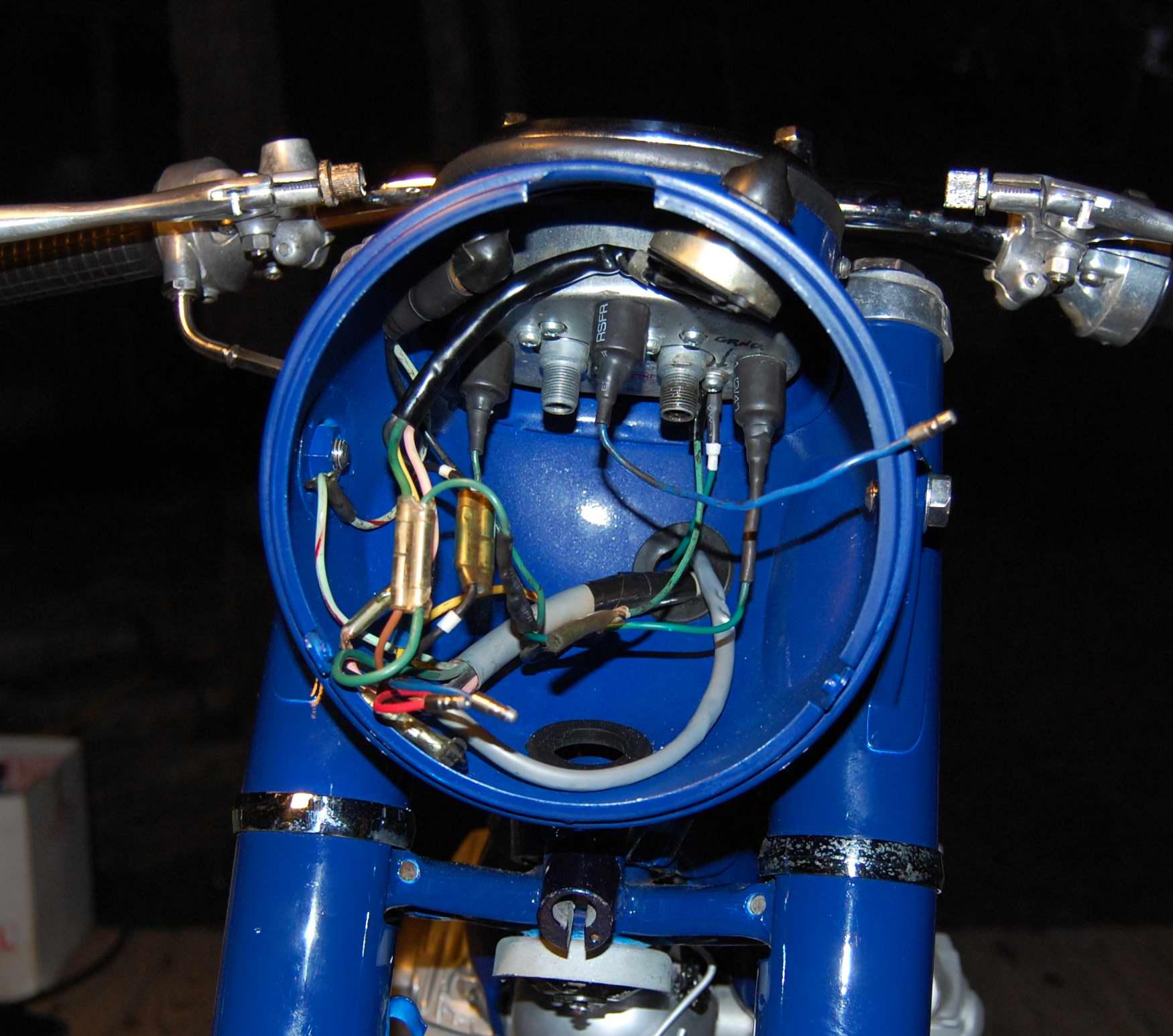

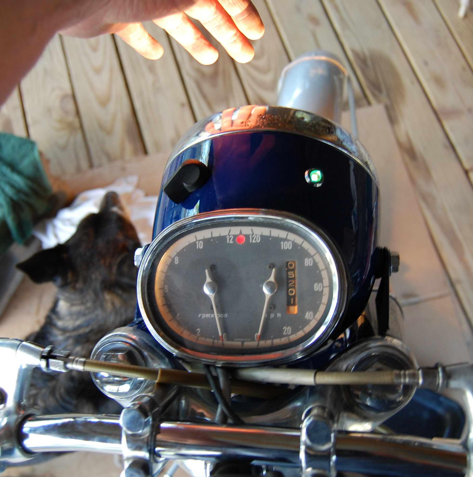

Wiring, lights, horn: Wiring is done, lights all work after a little tweaking. Taillight wouldn’t work consistently at first, would come on then go off or not turn on at all. I tracked problem to the combo switch; sometimes it was getting power to proper terminals, sometimes not. Concluded that contacts inside switch were dirty after sitting for so many years, exercised the switch by turning it off and on and on to parking position and back a bunch of times and taillight started working consistently. Working fine now, every time, I’m still exercising switch a few times when I think to. Only problem was when I hit the horn button, it gave a weak squawk and everything quit working. Blown fuse. I’ve got a new supply of 15 amp fuses, but putting off trying to fix it for now. It worked, but not real well, with battery charger before I installed it, I guess I need to go over it with multitester, see if it’s shorted out or what. I may need a new horn before inspection time.

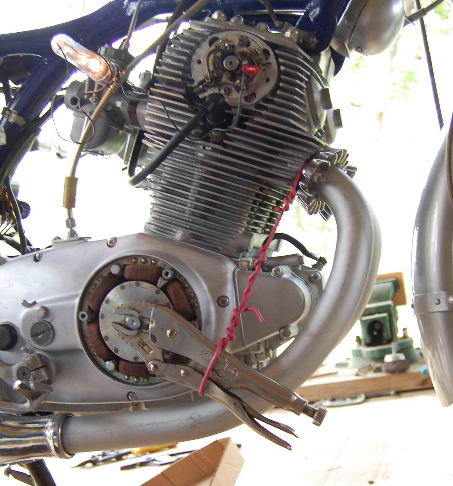

Mufflers: They went back on easier than they came off, since I’d figured out exhaust pipes need to be loose at head. Still a little challenging, the angle going on to bracket has to be just right, everything under a little tension. A matter of twisting and turning, thinking it’s impossible, and suddenly it slips into place too fast to know just what you did to get it there.

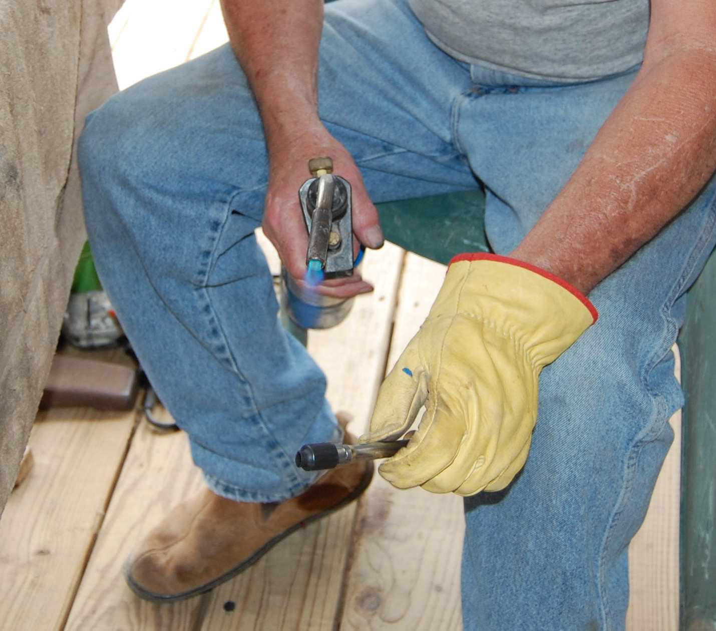

I painted the exhaust pipes with high-heat (1500 degree) flat silver paint, baked in oven for most of one morning, 30 minutes at 250, cooled, 30 minutes at 400, cooled, 30 minutes at 600, cooled. Stunk up the house a little. I think they look pretty ok.

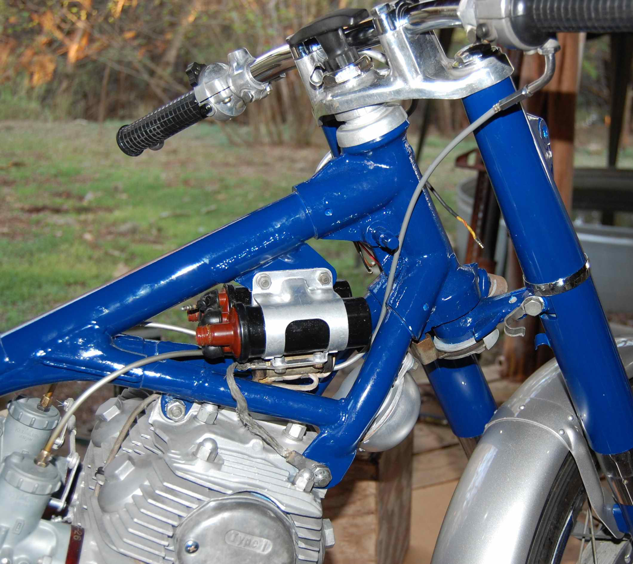

Cables: I got all the cables installed, including cruddy rear brake cable I’m going to replace as soon as retrobikes has theirs available. Tech tip: Stick your rear brake cable in place when you install the toolbox, before or during installation of rear fender, to avoid difficulty and possible scratched paint.
I scored a new original clutch cable (with grease fitting) from a really interesting guy I tracked down in Pflugerville (near Austin) who has quite a collection of beautifully restored CBs and CLs and other period Hondas. He’s working on a Sport-65 right now, and I just happened to have most of the parts from two S65 engines that someone (can’t remember who or why) stored in my barn and never came back for back in antiquity. Useless to me. So, a trade. Got the clutch cable, a pair of spark plug wire stays that go on carb bolts, some fuel line clamps, a vintage mirror with HM logo (not for CB77, I’ve bent around on it some, still can’t see anything but my left elbow in it, but it’ll get me past inspection.) I’d like to post a few pix of his collection, but need permission first. And time to do it. He’s a forum member but doesn’t really keep up with it.
Some agonizing over throttle cable routing. It may be of more general interest so I posted that story separately: http://www.honda305.com/forums/viewtopic.php?t=3977
Timing, etc.: I used Ed’s method to set the timing and synchronize the carbs, no real problems. Directions don’t specify that light should come on when mark on rotor lines up with pointer when rotating engine in normal (clockwise) direction, but I guess that’s obvious. Similar to a VW bug, which I’ve done quite a few times, but with two sets of points. Cranked it over and got good spark at both plugs, hallelujah.

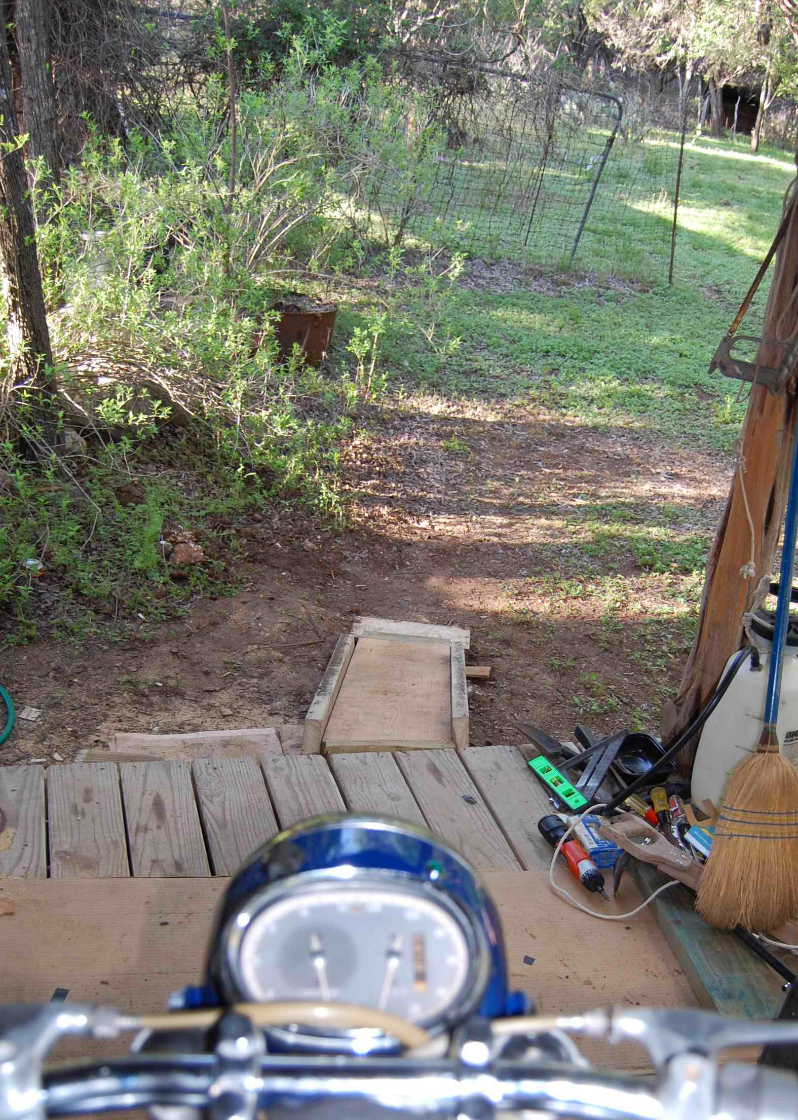

Getting it off the porch: Kind of like the guy who built a boat in his basement here. We just pushed it up a 2x6 to get it up there, but I think something more sophisticated is called for here. In the old days I thought nothing of riding bike up a 2x6 into the back of my ‘52 Chevy pickup. Depending on how far into the bed the board stuck, it might pick it up and fling it out the back. Harder part was backing it back down the board, but if it fell off, at least bike was out of truck, and it was accustomed to hitting the ground. I thought about just riding it down the steps, but that might be a little too exciting for my first ride in 30 years. So I took a window header I’d salvaged from somewhere (two 2x12s sandwiched with ½” plywood spacers, a little over four feet long) and built a ramp at the “shallow” end of porch. Main complication there is that coming off porch at 90 degrees puts me into some landscaping pretty quick, so ramp had to slant off to the right a bit. Haven’t had to cut a compound miter with a cheap skill saw in awhile, still not very good at it. Oh, well, it’s not a piano. I spent most of two afternoons messing with that darned ramp, but it’s done, sturdy, removable, ready to go. I’ve been walking up and down that ramp like Evel Knevel for the past week or so.

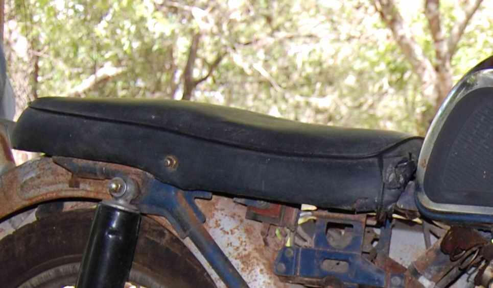

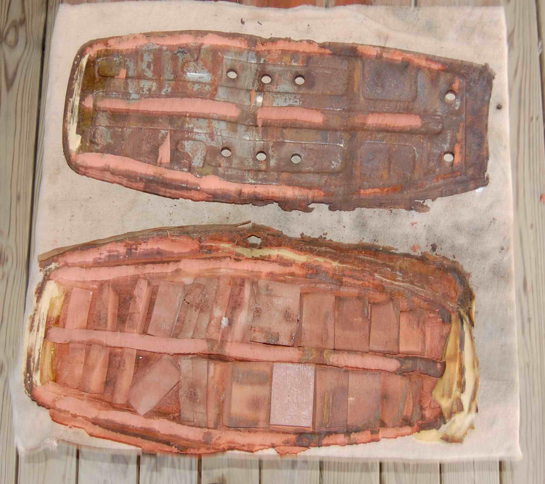

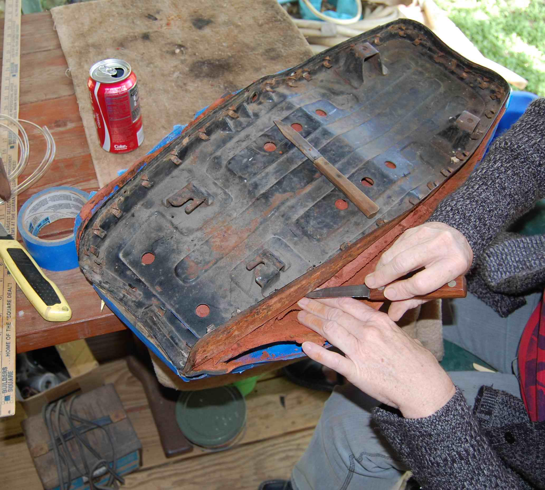

Seat: I’ve assembled all the materials I hope…electric knife, high density foam, quilt batting, contact cement, tubing to split to go around bottom edge, etc. I really think between the two seats I’ve got we’ll be able to come up with enough original rubber pads etc. to make it work. My wife has agreed to help with this; upholstery is something she claims some expertise at, it’s just a matter of being patient until the zodiac revolves around to us both wanting to mess with it at the same time. She’s not really that into the bike, but says she’s thrilled that I’ve found something to be so interested in. After a couple of years of retirement I really was in the doldrums until I started this project. She’s being very supportive, not complaining about feeling neglected (an understandable feeling all things considered), and I’m so grateful. Thanks, Sweetie.

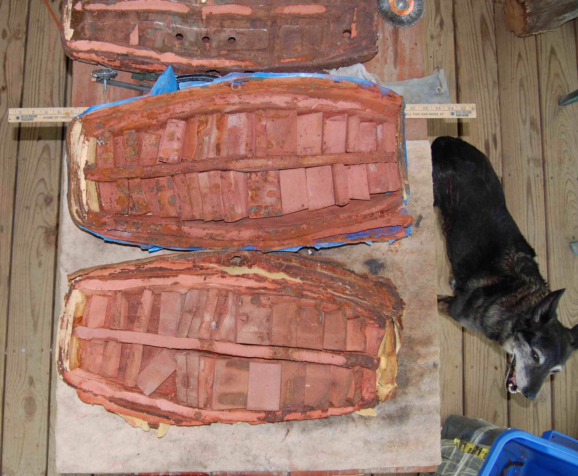

Later seat update: Last Sunday my Sweetie butchered the second seat so I could clean up and paint the pan. I mostly stayed out of the way. I got the pan wire brushed, de-rusted, a couple of coats of black paint on it. As I write she’s on back porch gluing together salvaged rubber parts. I’m still staying out of the way. Next step will be to stretch the new Canadian seat cover onto it.

So, with any luck, I’ll be hitting that ramp and riding off the porch and into the neighborhood sometime this weekend. Can’t go far, not strictly legal yet. I guess I’ll put the rusty ’75 plate on it just to have something back there. I’ll be replacing my funky rotor and points covers with the new shiny ones and putting the flipper on at some point soon, too. Not a Superhawk without a flipper. Wahoo! -- Lee --

Good luck! Don't stop until you get to the bottom :)
I used to drive my bike (Yamaha 650) up a ramp on to the bed of the truck all the time. The last time I did it, I just had a new clutch put in. I told the mechanic I was drag racing it, so he set it up so it up to grab a little harder. The new feel of the clutch was just enough to mess me up and I stopped half way up. Not a good thing :) I lost my nerve and I have pushed it up ever since. I think you can make your ramp no problem.
