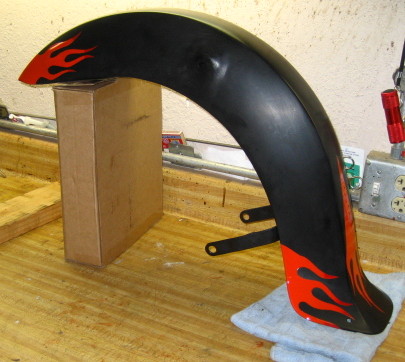

The weather is still not cooperating! I've got some painting done, but I've found that if I paint in the afternoon (when I usually have time of course) it's too hot causing the paint to dry too fast. I'm using enamel paint, in the cooler temperatures, when painting sucessive coats the overspray melts into the previous coat for a nice smooth finish. When it gets warmer the overspray dries before it hits causing a rough surface. Daytime temperatures are running high 80's to near 100 degrees F.
It didn't help any that I had to replace axle seals on my pickup yesterday, the one day this weekend I though I would be able to work on the bike.

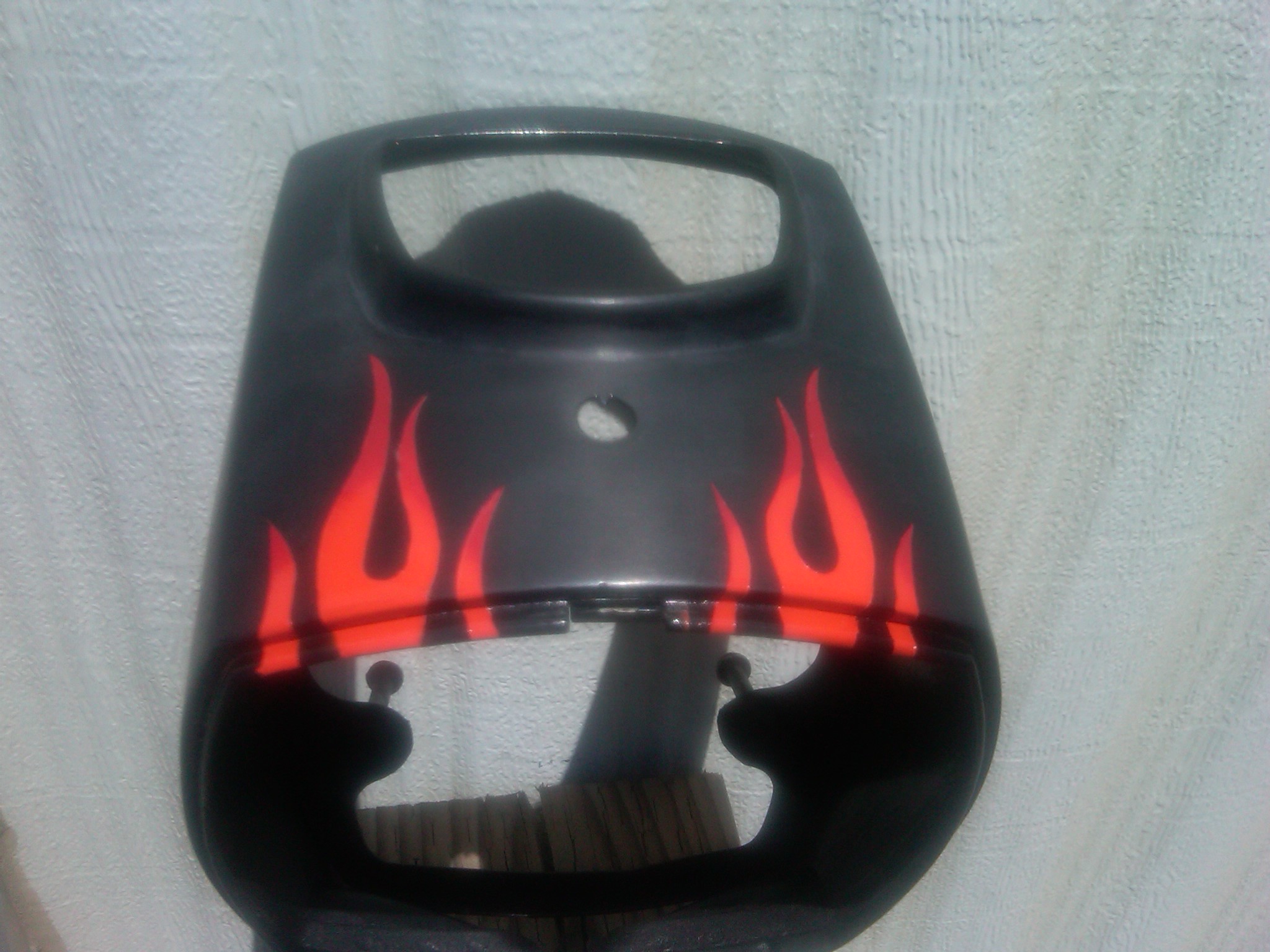

I decided to paint the bike black, but I'm working on putting my personal touch on it in the form of flames. I've done a test flame on the headlight housing, I think my system will work out fine, but of course this is just a small piece.

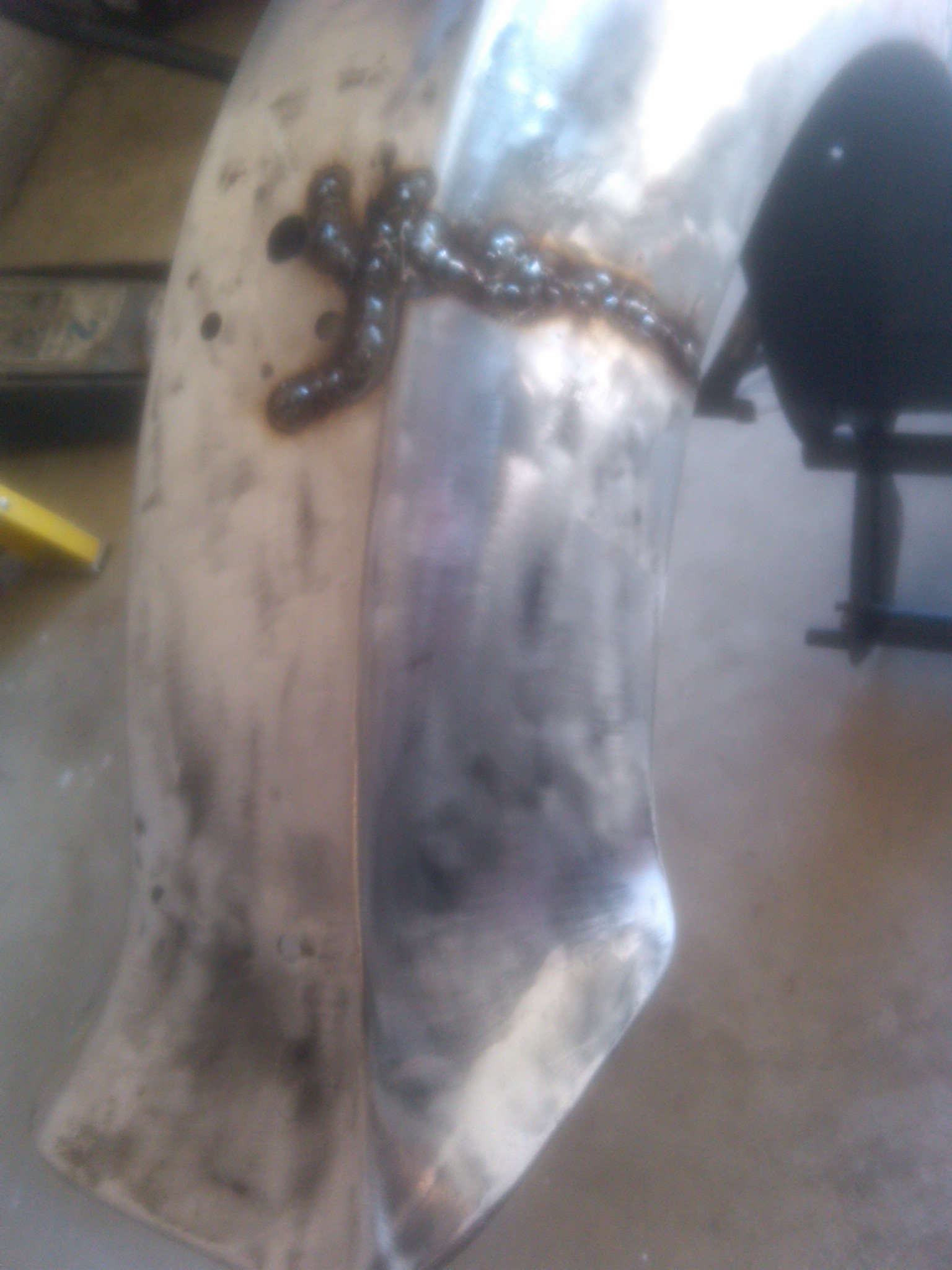

Seems like I end up putting out monthy reports. I've painted all the misc little pieces and both side covers. I've baked all the pieces I can fit in the oven (I'm using Duplicolor Engine paint.) I ran into one problem there. the left side cover had some Bondo on it which I left on. Apparently there was something there that expanded and caused a bubble when heated, so I stripped it, straightened it and used spot putty and repainted it.
Now I've started on the main frame. The tube for the steering lock was pretty well destroyed, as far as being able to install a new lock, so I cut if flat and welded a plate over it. One of strips for the bottom of the left side cover was broken on one end, but that was easily welded.
The major project is the rear fender. As you can see there was a major crack on the side. A PO had welded up the side but hadn't bothered to line it up. The repair was done with a bunch of Bondo. There were also several cracks that went across the top that hadn't been repaired. I cut out his patch and drilled the ends of all the cracks and rewelded. The picture isn't the finished product of the welding, I just got it back to it's original shape. I also found 2 holes in the back of the fender. Apparently something was mounted there causing a crease and a crack next one of the holes. They're all welded now, so its on to the final shaping and painting.
