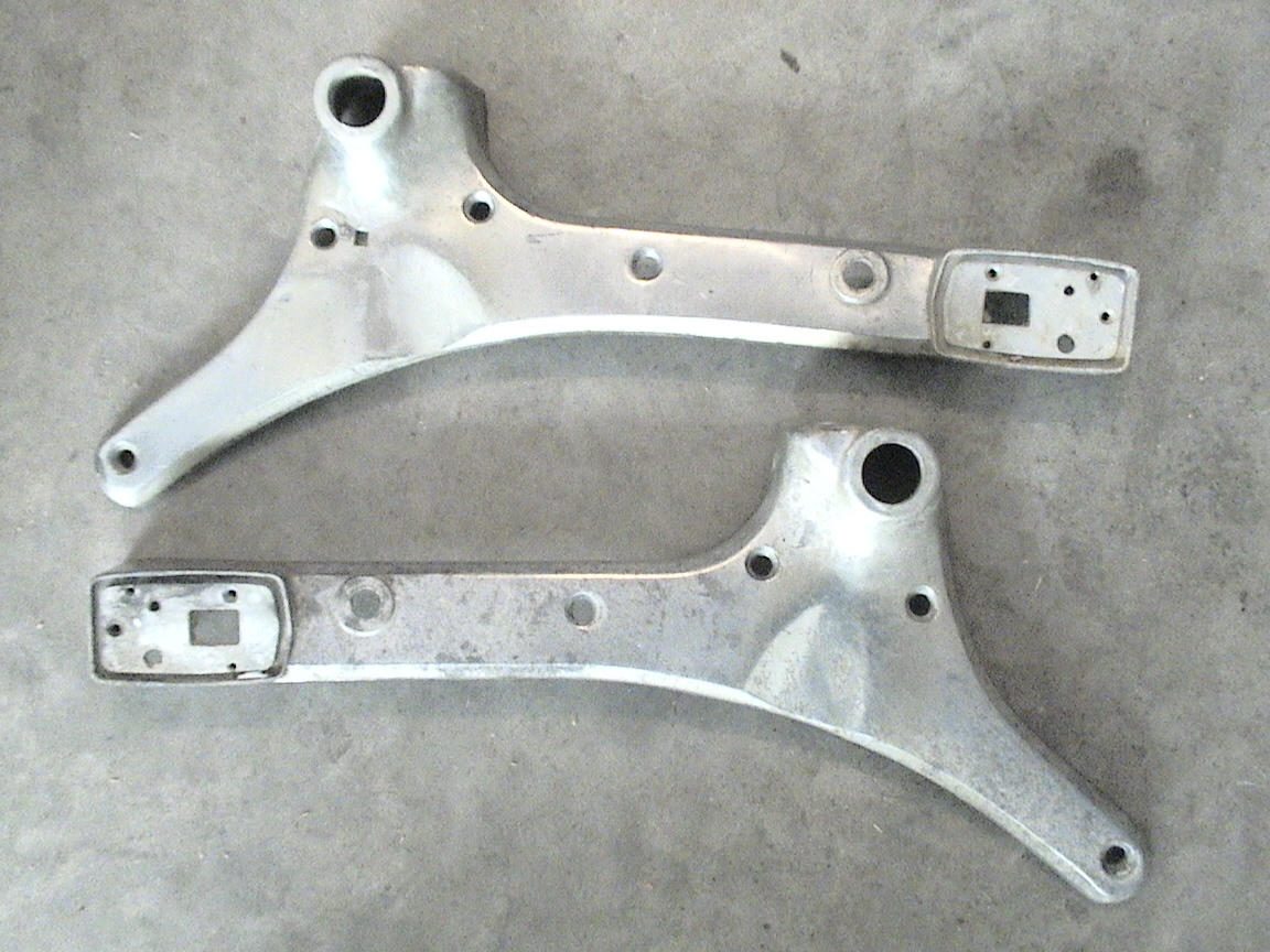

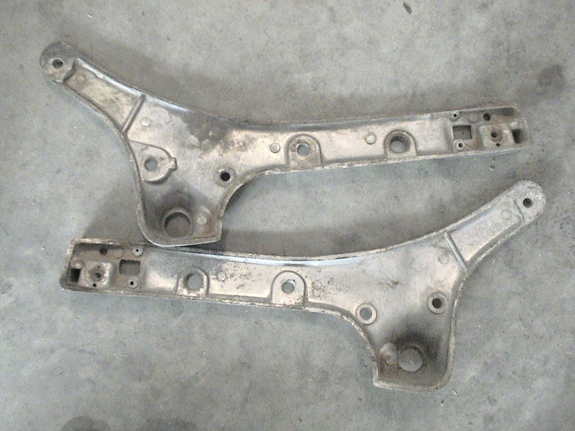

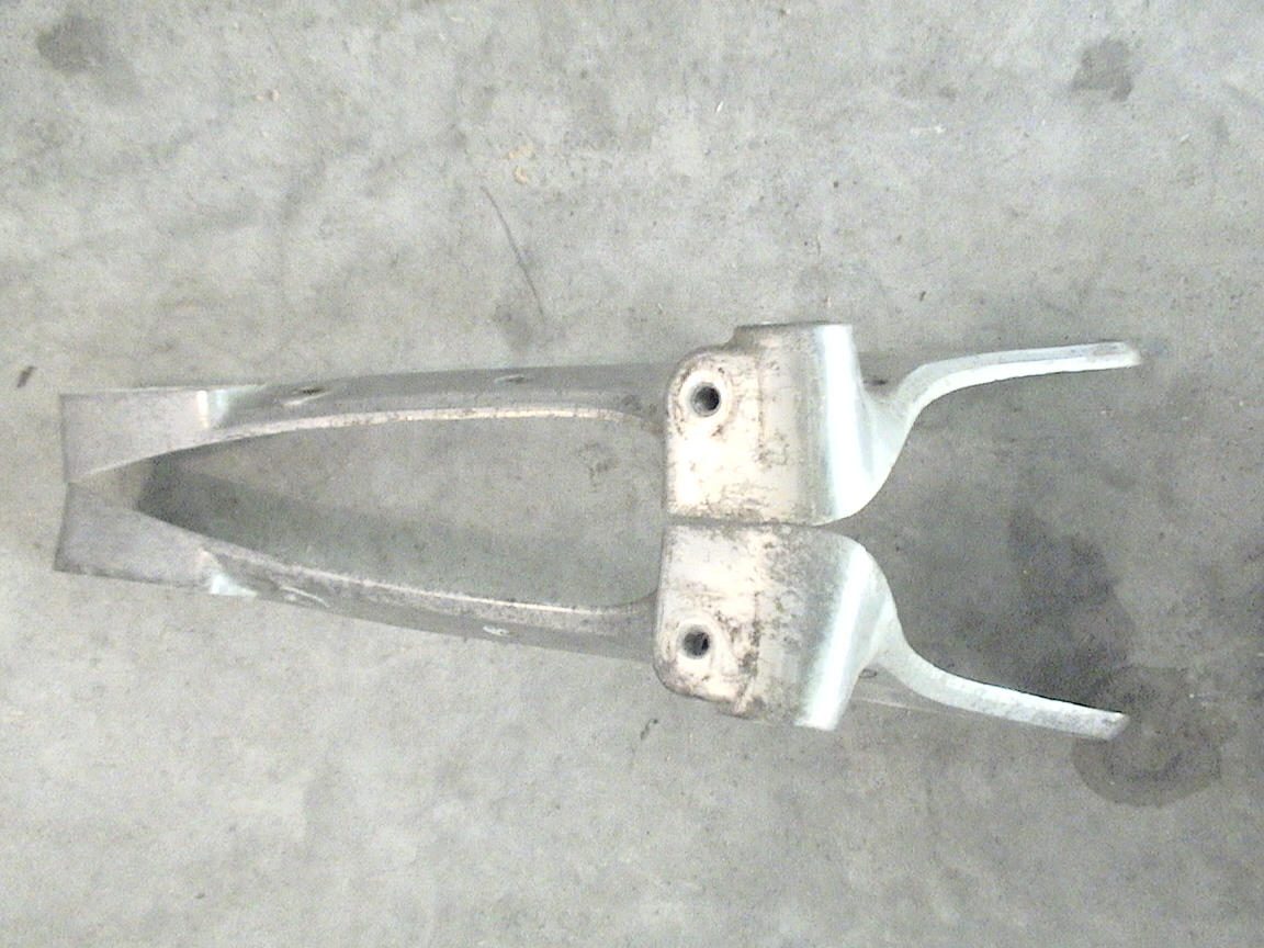

Post by brewsky » Sun May 19, 2013 12:58 pm
Let me dig them out and see what they look like.

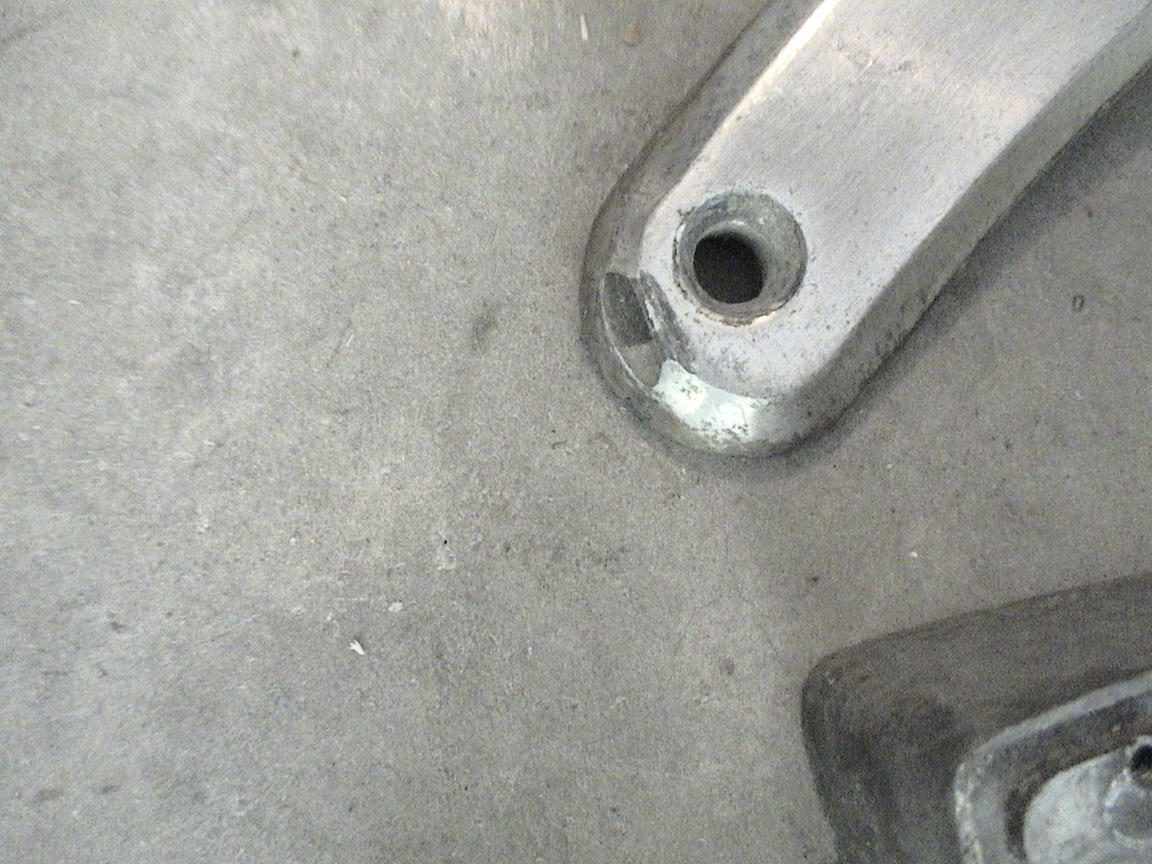

Post by brewsky » Sun May 19, 2013 1:44 pm
Here are some crappy pics,..... I'm not much on photography.
The only thing I see that wouldn't sand/polish out is the very front end of of the left one at the mount hole. (See close-up pic)
Looks like the side cover had been rubbing against it.
The female threads for the little covers are good, but I don't have the covers or extra screws.
They are yours if you can use them.
