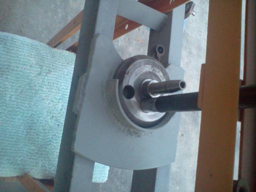

The first pic below is the end of my crank that is bad. PO apparently rode it a ways while the starter clutch had insufficient oil. Must have made a God-awful noise. You can barely see the oil hole in the reflection line. It is about closed up. On close inspection I found that the shaft is cracked out from that oil hole. CL72 shop manual says the end counterweight pieces are made of carbon steel.

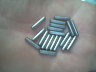

The second pic is the jig I made in action in a 12 ton press. Jig is resting on a new cross-bar that I made up. You need a 1/8" spacer for the end that goes farthest into the jig because the inside surface of the counterwieght is not flat. Got some good pressure on it and then hit it with a 3 pound drilling hammer. It moved a little and then the press did the rest of the work. Have someone catch the rest of the crank or the con rod could come off and scatter those little roller bearings to Kingdom come. I caught both this and the donor crank, and avoided that problem, but did briefly lose one of the rollers from the donor crank. They are pretty small.

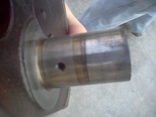

First pic is the con rod shaft. I got just a little bit of crud out of the oil holes. When you use carb cleaner I think it flushes a little of the crud out and and softens the next layer each time you shoot it into the crank, so if you start that process, probably a good idea to do it a number of times over several days. The last couple of times I sprayed the carb cleaner, what came out looked pretty clear. I am not sure how you can tell when you are “done”.

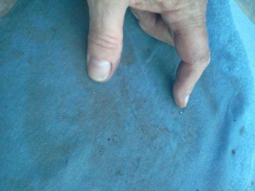

Last picture is what came out of the crank after gouging out the impacted crud and spraying carb cleaner through the con rod shaft, annular groove and inner bearing. I got a little dirt and 2 metal pieces and I am not at all sure where these came from, but likely from a piston that came apart early in this motor's life and repaired by the PO. If that is the source they went through the oil pump and inner roller bearing without causing any significant damage and I think were caught in the annular ring so they didn’t make it into the con rod bearing. Simple, but effective Japanese engineering. When you start loosening this crud up, it can send metal like this through your motor. It may be that my prior question about whether it is just better to leave this stuff compacted and in place may be the better way to go. I haven’t decided what I think yet. If you loosen it up it could go through the motor. If you leave it in place there may not be any room left in the annular ring to catch the next piece of metal. In either case, it seems like the annular groove was designed to catch and hold crud and metal and, if doing its job, it will fill up again at some point.
In spraying the carb cleaner through the subject end of the crank I got a little dirt and 2 metal pieces (by my thumb and forefinger).  I am not sure where these came from.
Just like Teazer said there was about a teaspoon of compacted crud in that annular groove.

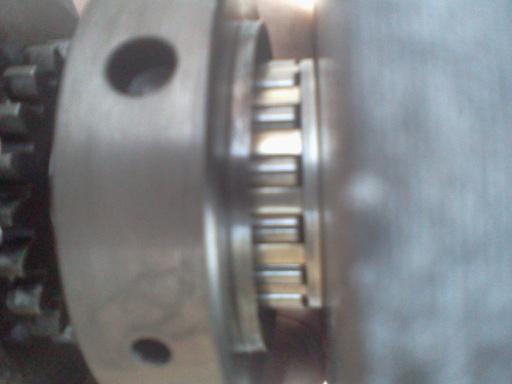

The inner crank bearing next to the cam chain (smaller) sprocket will slide over enough to let you see at least part of the rollers.  No rust or pitting here either.  Just to the right of this bearing is one of the annular grooves that Teazer talked about
No rust or pitting in the con rod roller bearings.  Cage looked really good as did the inside of the big end of the rod.

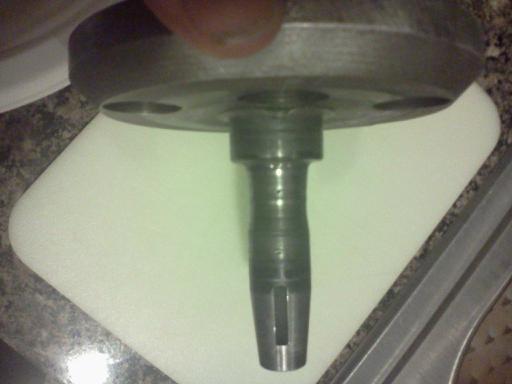

The con rod shaft.  Stained, but smooth.  CL72 shop manual says inner counterweights are chrome-moly steel.  Some crud in the oil holes, but not much.  I had flushed this several times with carb cleaner.
