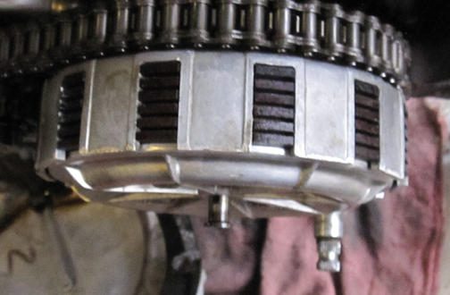

My 66 CA78's clutch has a 5 friction plate clutch which I believe is a cush. The way it was assembled was:
Clutch center
A plate
Friction disk
B plate
Friction disk
B plate
Friction disk
B plate
Friction disk
B plate
Friction disk
Clutch cover
So, a few questions: (1) When I get them, where should the ring spring(s) go? (2) I have a cracked friction disc and am going to replace them, should I replace the B Plates also? (3) Should the clutch springs be replaced as a mater of course?
