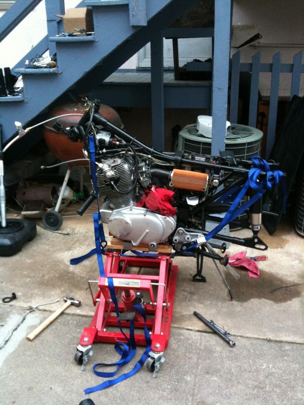

So I pulled the engine to take a look at what could have possibly been causing the odd noise. Looks like the master link is top dead center still. There weren't any marks on the pistons or valves to indicate contact.
Here's a link to the video with the clicking sound for anyone that'd like to take a listen.
I found that the left exhaust valve is open about 3mm at TDC. It shuts when the cam is moved just past TDC. Is this normal? There's a few times throughout the rotation where each valve will stay open about that amount for a moment. Should the valves pretty much be open/shut or are there a few instances where this is expected throughout it's revolutions? A friend noticed some blue smoke coming from my left exhaust, I'm wondering if this is the culprit.

LM is right on target when he asked about the crank position. The cam link will be wherever it happens to be. I don't always put them on top, sometimes they are one or more teeth off.
What is vitally important is that the cam is in the right place when the crank is at TDC. With the head off, we can't tell, but do you remember where the cranks was positioned when that picture was taken?
