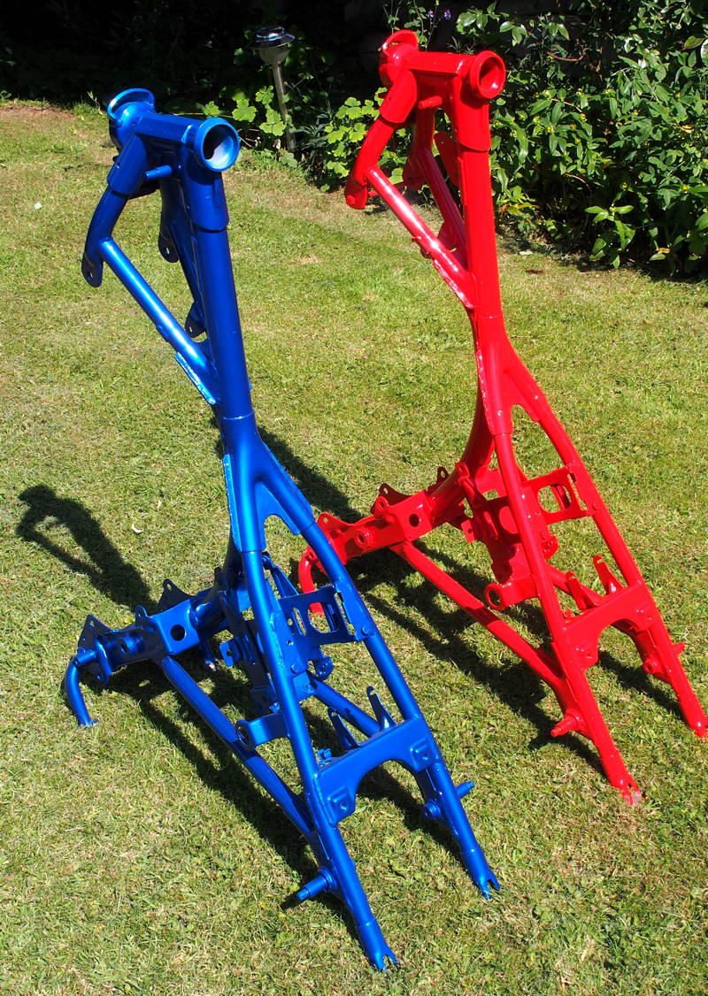

Looking good. More of a Taa Daa! than Ah Ha, me thinks. You are welcome with the gas torch idea. Just don't go using it on the gas tank unless you KNOW that it is clean and dry. Not sure what the product names are in the US but try a little phosphoric acid on the parts when they are warm (not hot) and you'll be amazed at the results...
Love the finish on your frame. I am in the US on business again so not much resto work going on. Did manage to get some frames painted before I came out, though. I'm sure you'll get some volunteers to help you with the lifting..... :-)
