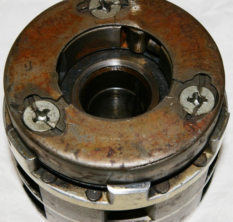

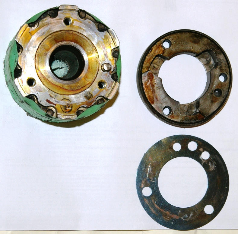

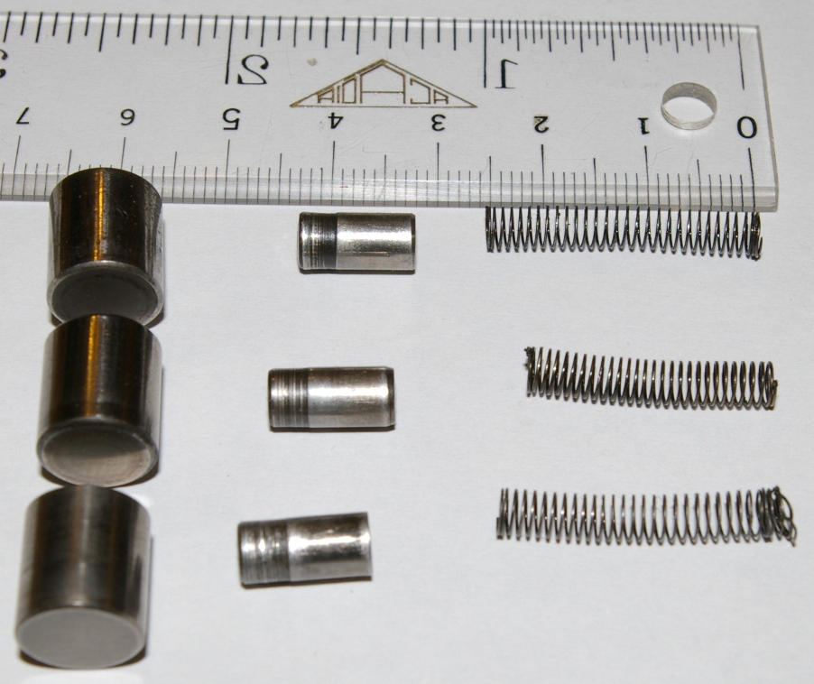

When I pulled the rotor I didn't like the looks of the starter clutch outer--the steel shell was badly cracked and pieces of it had broken away and disappeared somewhere.

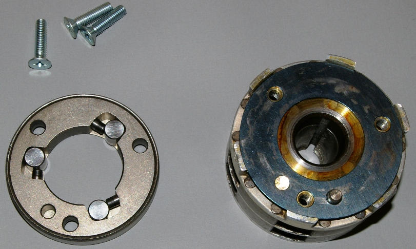

Only one spring looked close enough to spec, two of the rollers were slightly under spec and the cups didn't all look the same so I decided to replace everything.
I taped up the rotor so that I could use the Dremel to grind away the peened sections of the bolts without the filings sticking to the rotor. After a few taps with the impact wrench the outer came off and I could see why the clutch was temperamental.
It was in two pieces! I don't know why it would have broken like that, but it was for sure not usable and likely to grenade at some point.

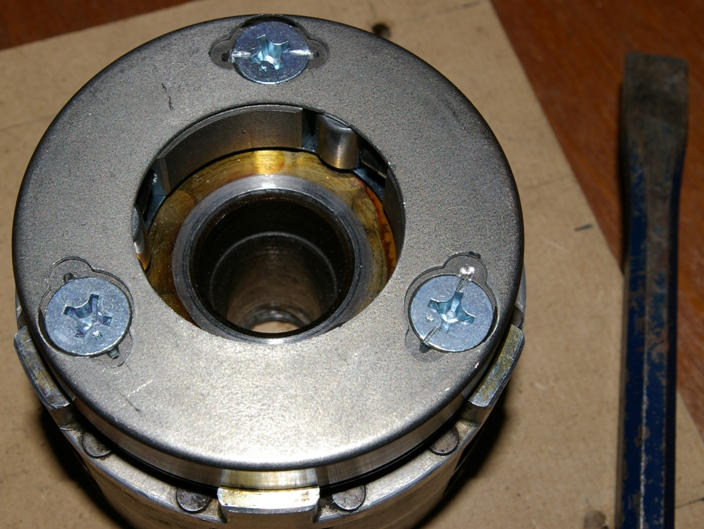

The new outer did not have the peening groove machined into it so I had to do some grinding with the Dremel before bolting it on. A few taps with the chisel should prevent those bolts from working loose. Now, with rotor and stator re-installed I can get on to replacing the timing chain and advancer springs.
One last bolt to peen...

rollers, springs and cups...

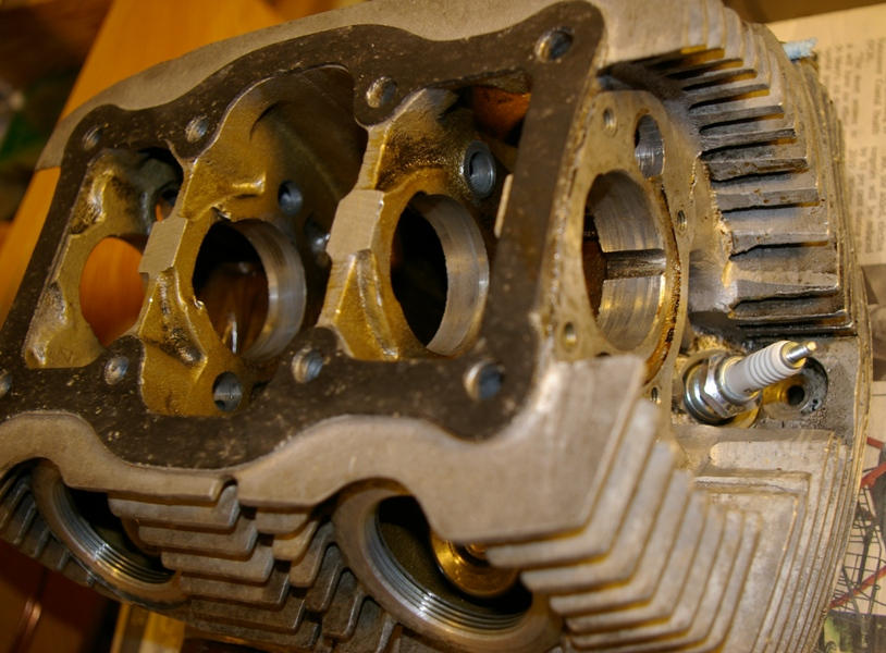

I took the cams out to replace the worn advancer sprocket and after spinning the bearings and listening/feeling them, I decided the two outside cam bearings were iffy, so all four will be replaced.
The photo shows a groove in the head where the right outside bearing goes. There is no such groove on the left side and I can't recall see any photos that show such a groove. I'm wondering if this is original--I don't think so, judging by the uneven, almost crude machining.
Has anyone else seen this? Are there any guesses as to its purpose? If it shouldn't be there, is there a way for me to correct this?
