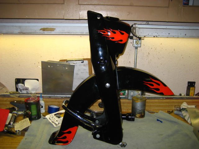

Painting is mostly complete. Rear fender flames are done. I still need to paint my flames on the tank, but the weather has cooled considerably so that will wait a while. I've installed the wiring harness and brake wiring, with new grommets in the frame wherever possible.

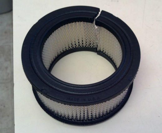

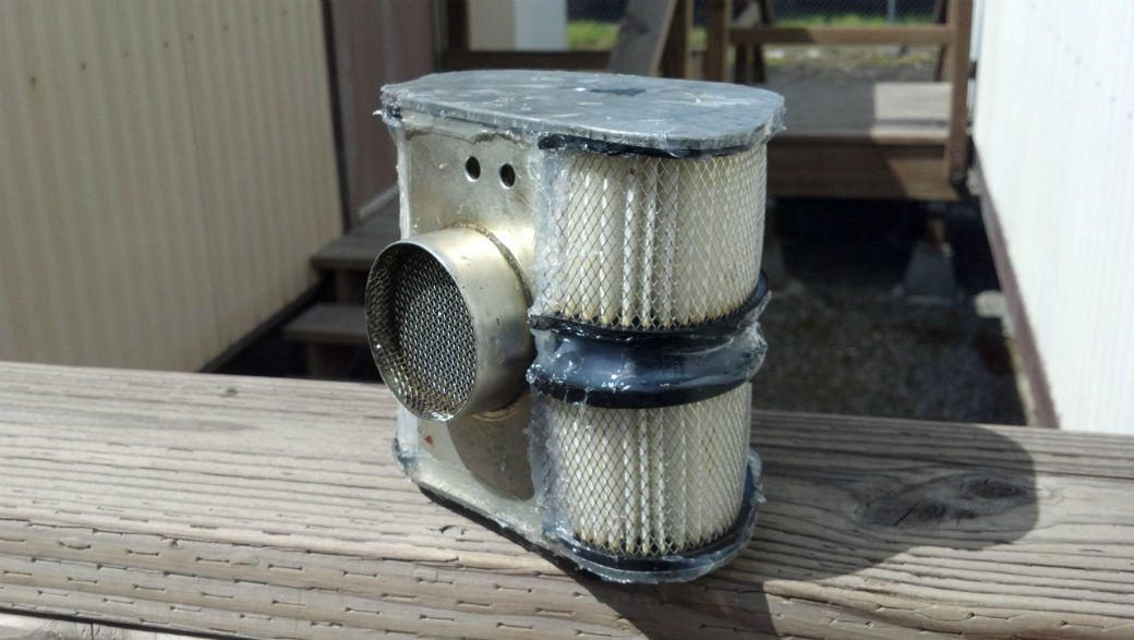

I'm in the process of refurbishing the air filter. I've taken 2 4" diameter filters ( used for 12hp engines) and fit them side by side. I think it will be fine, if not I'll go for a reproduction.

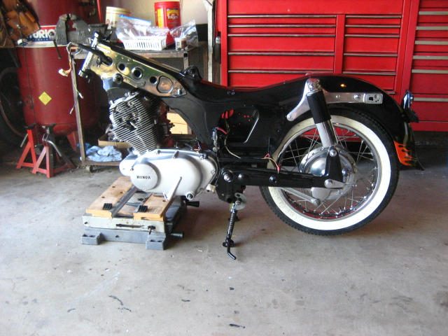

I haven't been taking any pictures, but hope to rectify that this weekend when I start assembling the major components. That is provided I get my garden planted first. According to the wife other things have priority, darn it!

In spite of planting the garden with the "help" of my 6 year old granddaughter who I had for the weekend ( one of those priorities I spoke of) while my wife was out of town, I did manage to make progress before and after her visit.
I actually have some pictures as well. I think the air filter came out pretty good.

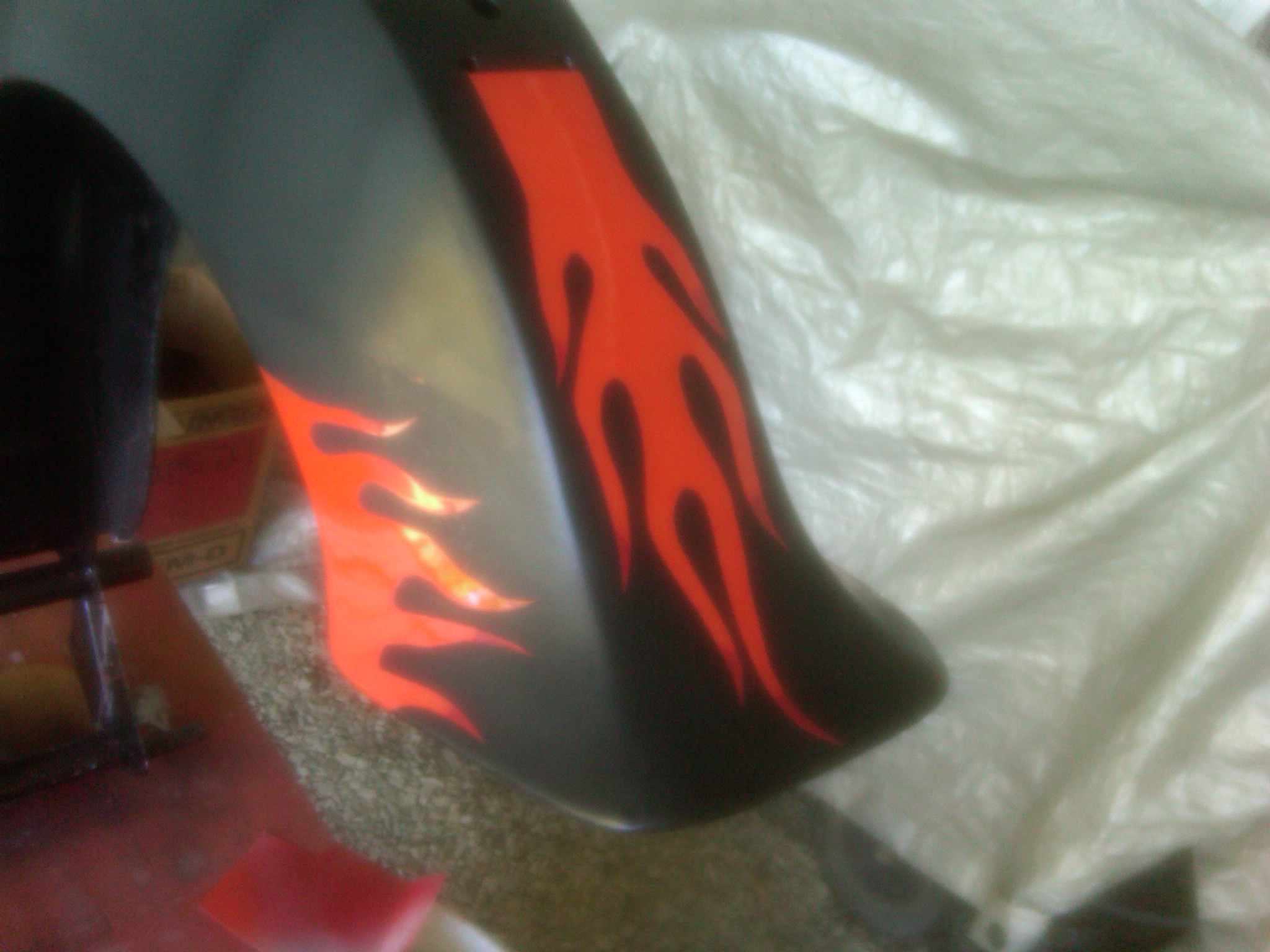

I was a little worried about the fit of the front fender. With the help of some cereal boxes I manage to get it into place without incident. To my amazement all the holes lined up perfectly. When I got it the rear brace was broken off, I had to weld it back in place. I think the key was all the measuring I did as I was putting it back in place.
