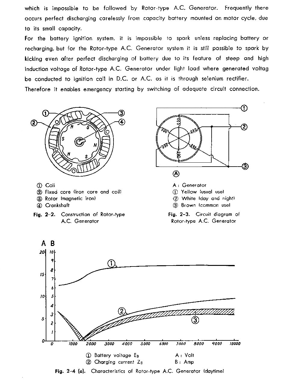

It's been a while but I remember seeing that alternator diagram before. I just traced out the circuits with a highlighter (only way to keep track) and it shows that the lighting coil is just the one pair of coils, which is how it is described. It looks like the picture in the wiring diagram is backwards and probably a bit misleading. So thanks for posting that. Need this stuff to jog some of my sleeping synapses back into operation.
I assume that the curve is for a typical 305 alternator. If so, it tells us that the charging current peaks at just under 5 amps at around 16 volts for 80 watts of power. That does make more sense when you consider how many riders look for LED bulb replacements to reduce the load on the charging system since rarely would you run at that peak power rating.

I refer to the stator wiring diagram that Jensen has recently posted. When I read it, it looks like the two coils at 10 o'clock and 4 o'clock are in series and provide a voltage between the Yellow and Brn (1 and 3 in the diagram) when the lights are off. The Pink (2} is a parallel connection of 2 o'clock and 6 o'clock and a corresponding parallel connection of 8 o'clock and 12 o'clock at the Brown (3) connector. This is consistent with the stator schematic showing 2 pairs of coils for the lighting function and 1 pair for the ignition function. If I'm reading this wrong, let me know!
With respect to AC voltage measurements: just to be sure before posting something stupid (I've done that before!), I poked my reliable DMM into a 120 VAC outlet. It read 122 VAC (we're on a grid that varies quite a bit), and I know from looking at my oscilloscope that there's approx. +120 - -120 peak to peak.
I'm curious to know how Jensen's diagram shows 2 pairs of coils being active in the "lights-off" condition.
