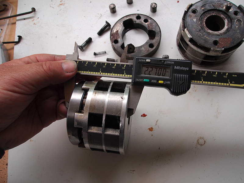

I'm the guy who started this topic, so, for the sake of readers who don't want to read every post I'll sort of summarize. There isn't complete agreement about the what actually happens in this tiny passage, but everyone seems to agree that drilling the 2 holes in the crankshaft should be done to mount an electric starter to a CL crank- so that's the first step.
Now I need a starter clutch, sprocket, motor,etc. Before anyone says 'just buy the correct parts' I'll defend my habit of adapting parts- there are only so many original and correct parts available- since I'm building a mutt of bike, there's no need for me to use up parts that someone may need for a Pebble Beach style restoration.
A CB350 clutch housing bolts right onto a CL77 rotor- the dowel pin is on the wrong side of a mounting screw but that's not a big deal- pry off the cover and transfer punch for the new pin, or cut off a transfer punch and put it in the hole to mark the new location.
I have a CA77 sprocket, and the 'nose' that the cluch grabs onto is the same diameter as the CB350 sprocket- so it should work- the springs from the CB350 clutch housing I scrounged had lost their will to extend, so I can't spin test the system yet.
I don't have a CB/CA clutch housing to measure- maybe someone does and can help. The CB350 housing is 0.500" thick, and mounted onto a CL77 rotor the assembly is 2.251" overall height- can anyone confirm this is the same as a genuine CB/CA rotor/clutch assembly?
It looks like the CB350 rotor and stator could be adapted also- rotors are different depth-
but the taper feels tight. The key in the rotors is phased different than the CL77, so the timing marks would be fouled up, but they could be rescribed- easy to find TDC with the heads off, and a degree wheel would be easy enough to mount.
The CB350 parts are dirt cheap- I'll do more fitting and report back what I find.
The CB350 clutch hub, basket, plates, etc look promising too- a little more work to replace the basket gears with a chain, but I could change to a more available chain at the same time.
It looks like tha CB350 starter chain is even the right length- I got a broken, rusty chain with my basket case bike and some starter motor parts- planetary gearhead, etc. Need to work on a motor next.
Thanks for all the help and advice so far- I'm having fun, hope you guys are too.
Rick

I like your approach to creative solutions. Nice measuring equipment. I'd try a dry assembly to see if it all fits. The rollers will probably grab without springs for evaluating whether it will all work together.

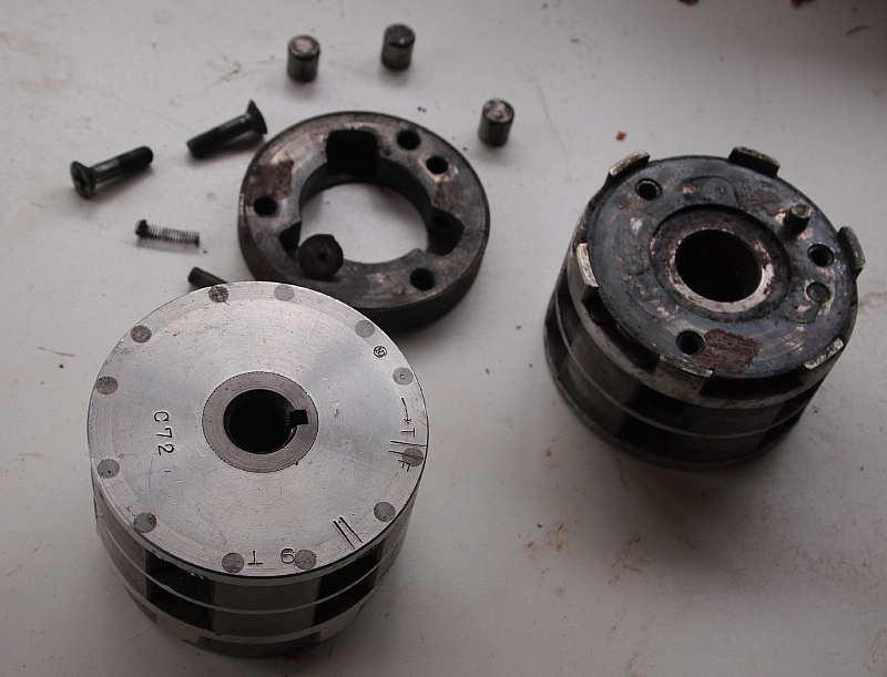

Looks like you are making real progress there! Here are some pics of the replacement assembly I bought for my CB77. The width of the assembly (both rotors marked C72) is 2.27" . That's a little bit taller than yours but not much. You should be on the right side at 2.25". CB250 / 350 parts are not as plentiful here and I managed to pick up my replacement for $18 I think on eBay US.
My original one was badly rusted and the screws holding the two parts together had come unscrewed, which must've made an interesting noise as they rubbed.
Keep us posted on this, especially how you get on with drilling the crank. I'm going to set up a fixture in my milling machine to drill the cross hole with a diamond burr. The central hole should be easy enough if I can get hold of a long-enough drill. I have a couple of used CB77 cranks but I would like my restored CB77 to have a new crank, if possible.
Have fun!

G-Man wrote:Rick
Have fun!
