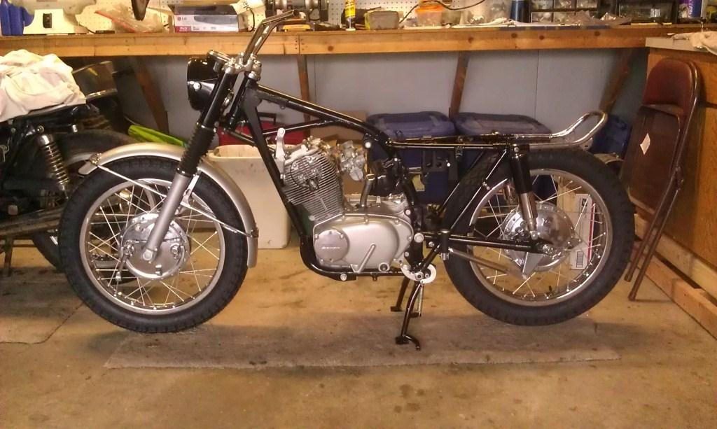

Post by jsmith1107 » Tue May 21, 2013 8:22 am

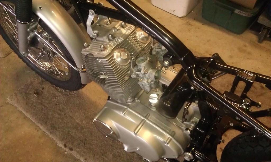

More progress made. I have the carbs all put back together and on the bike. I also have the brakes mounted and a few other things done. I am currently working on the wiring harness. I had three of them from bikes I had torn apart and in the process of making 1 good one out of those three.

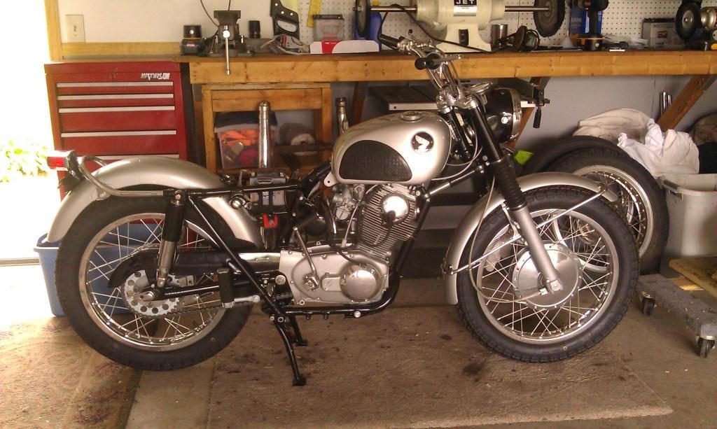

Post by jsmith1107 » Sat May 25, 2013 9:44 pm

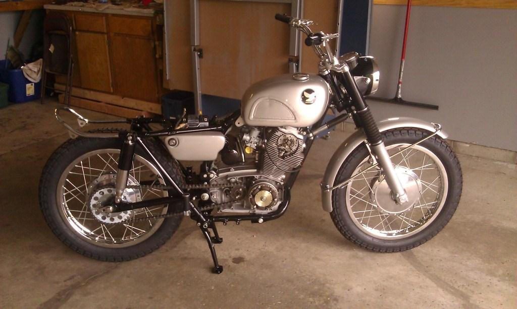

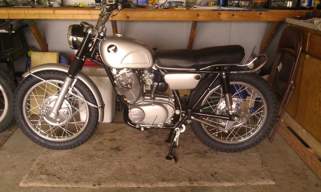

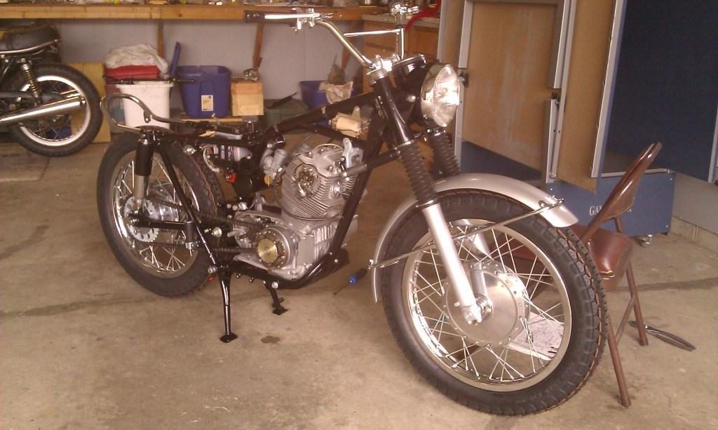

More progress yesterday--spent 8 hours working on it. In fact, got so lost in the work that I didn't come in from the garage until almost midnight. I re-did the wiring harness and put new gray shrink tube on it and found some really neat tape that is very sticky to fill in the gaps. Today I was able to get the headlight on and once I saw what that looked like, I just had to put the tank on to make it feel like I was getting somewhere.
ONE problem though, I cannot get the knee pads on the tank no matter what I do. I struggled and struggled but still can't get them. ANY SUGGESTIONS FROM ANYONE? Help would be SO appreciated.

Post by linmictil2 » Sun May 26, 2013 7:46 am
Don't know if this will help you but I put mine in boiling water to soften them up and then install. Seemed a bunch easier for me.. Your restore is is just plain pretty. Not that that is a "man" word. mike
