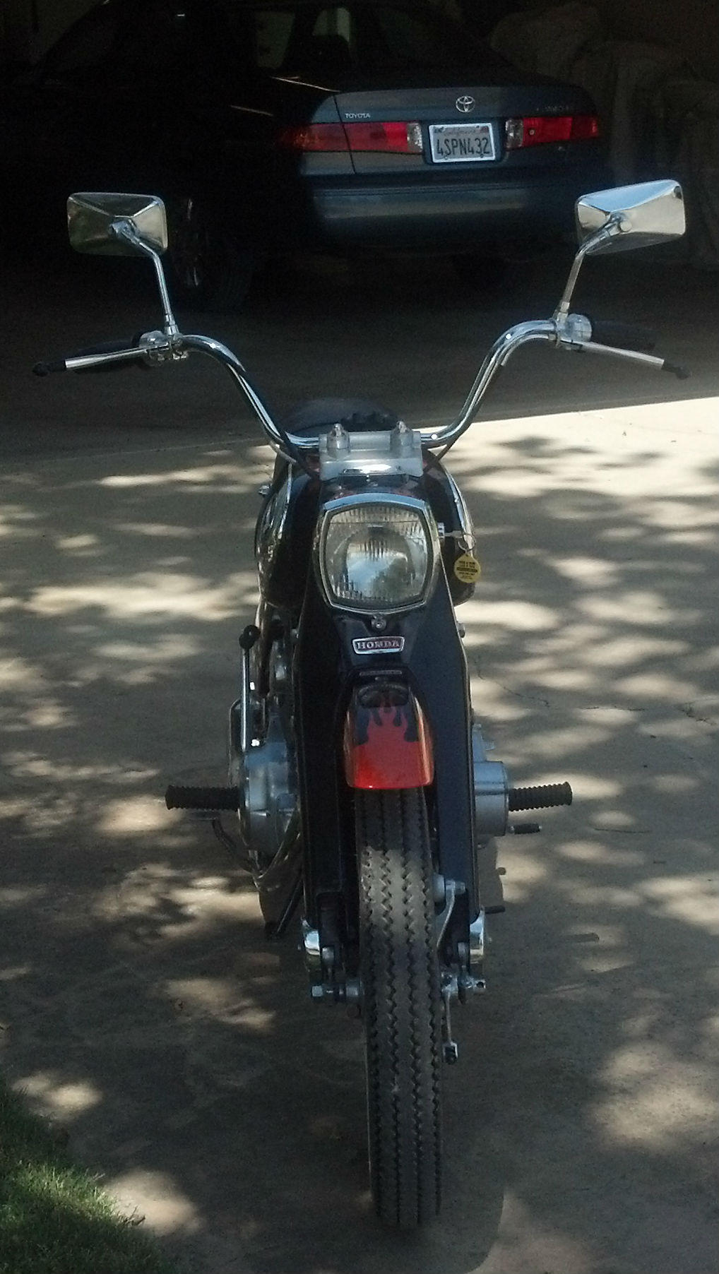

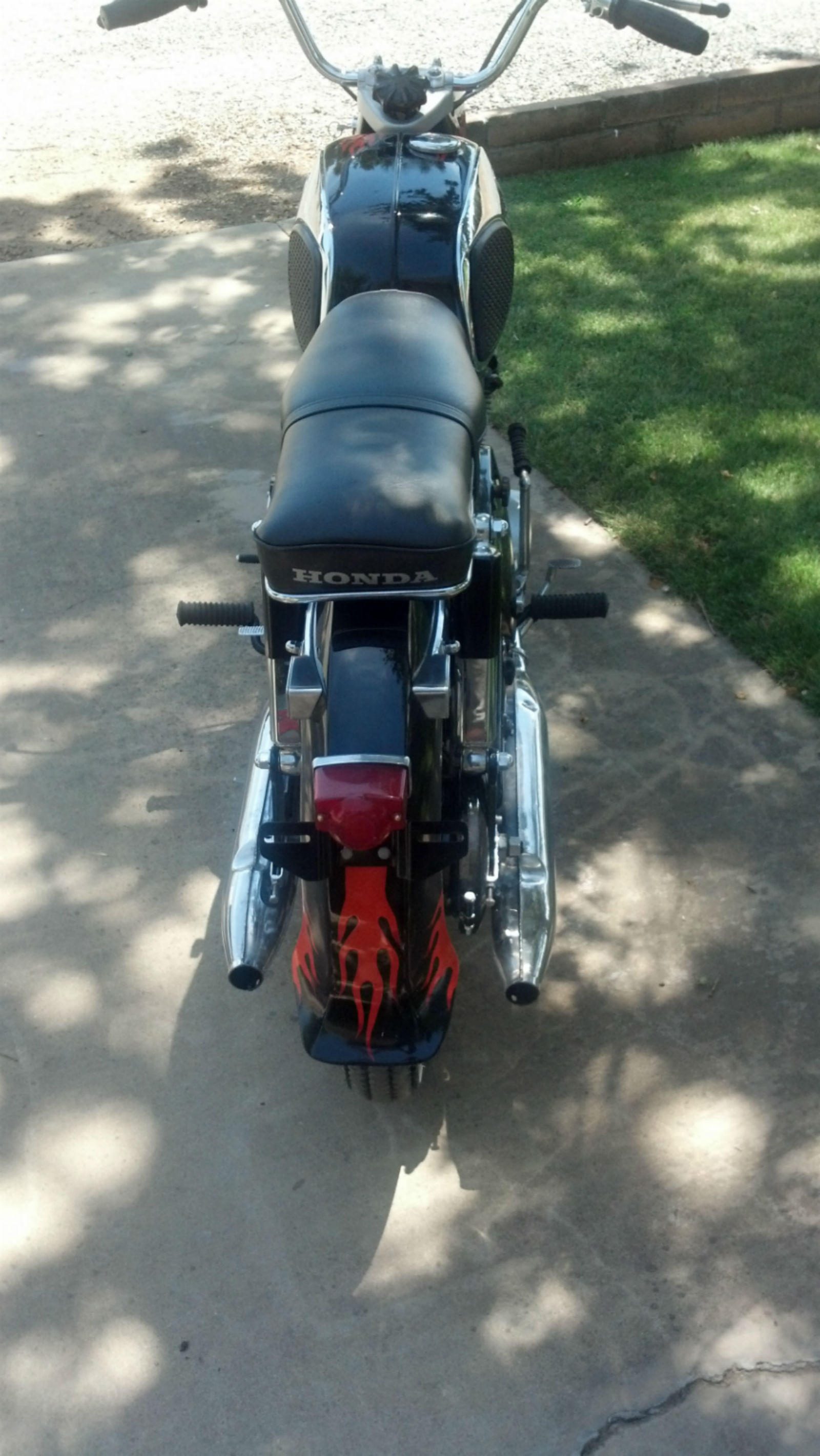

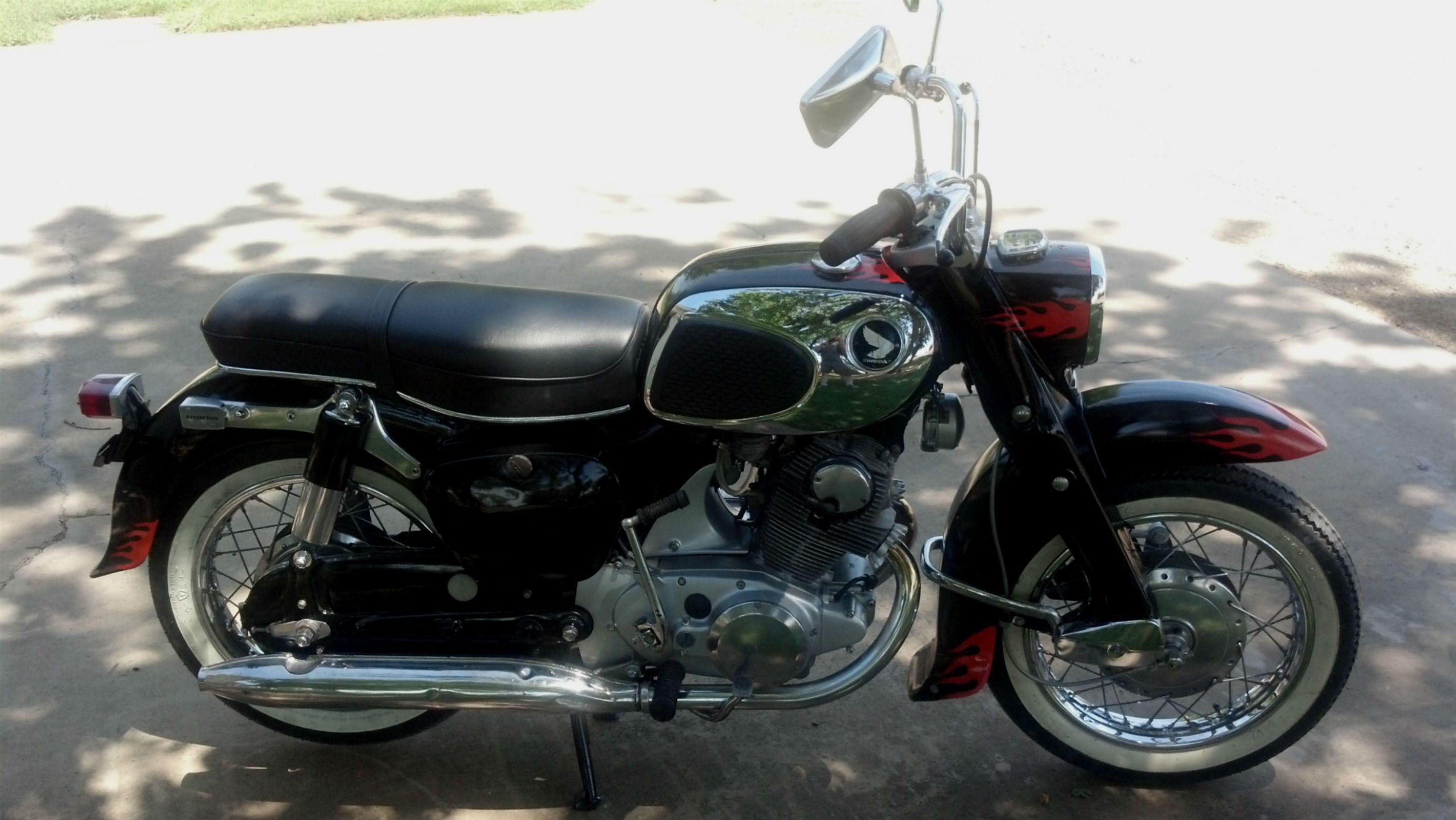

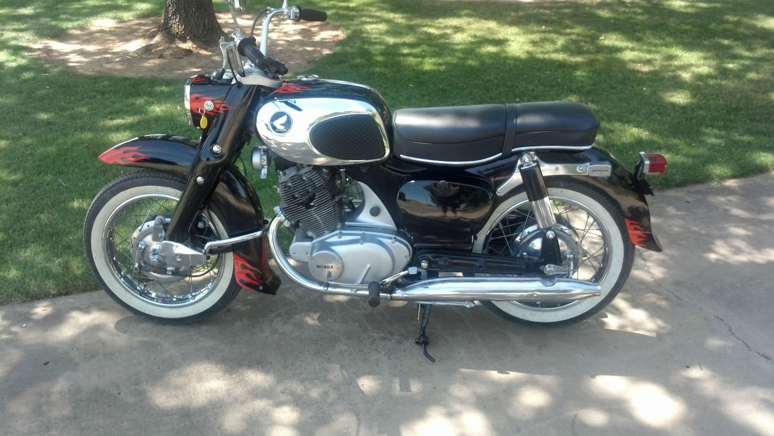

I've concentrated on getting the bike together and not had any time for posting. After a lot of fiddling around I got the muffler mount made and everything to fit well. Getting the valve on the tank to seal took some time, but no leaks now. It's together!! Not only that but it runs- and the short amount of time I've ridden it (around my place, not on the road) it runs good and no leaks so far. Right now I've got to make a final decision on what battery to use. The current one is enough to kick start and run, but not enough to even honk the horn (which works if I have the charger attached.) As soon as I install a battery I'm off for my VIN inspection at the Highway Patrol and to get it registered. I've already got the preliminary paperwork done, so it should be quick and easy. Notice I said should be.
