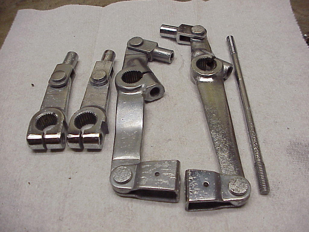

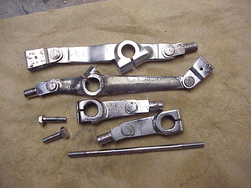

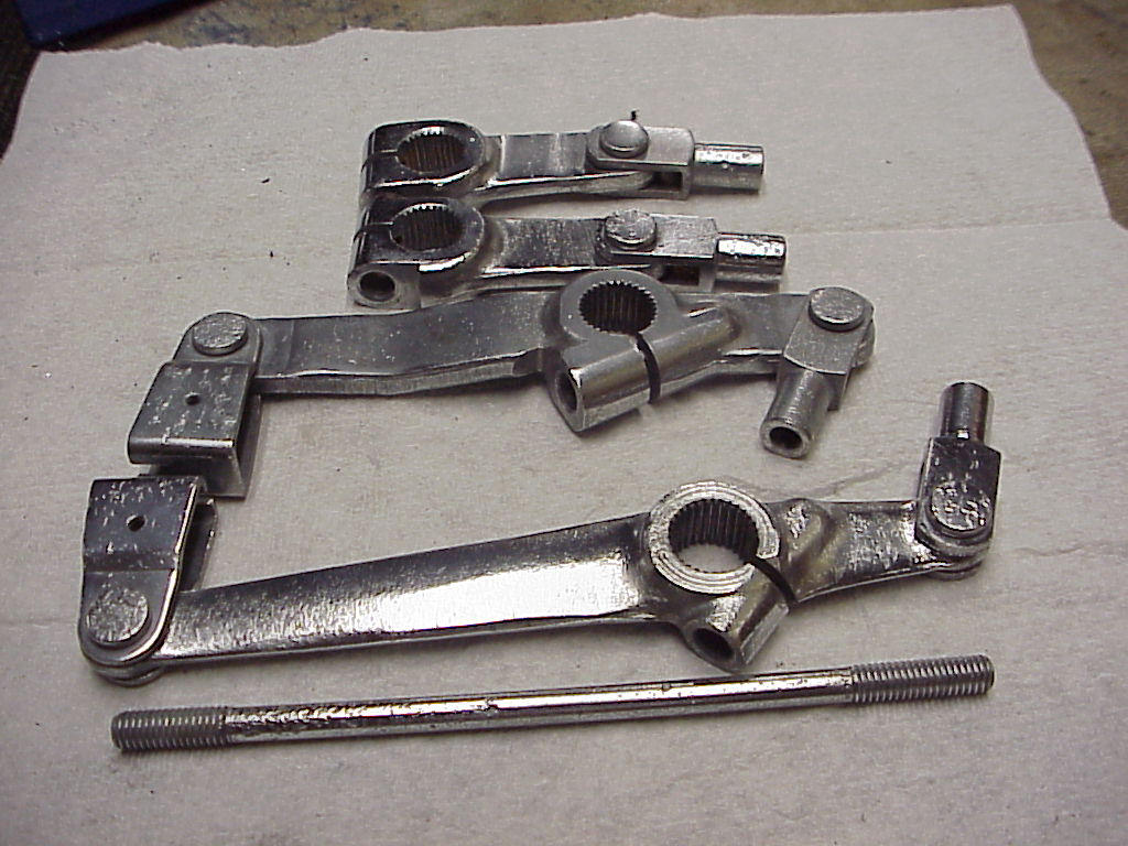

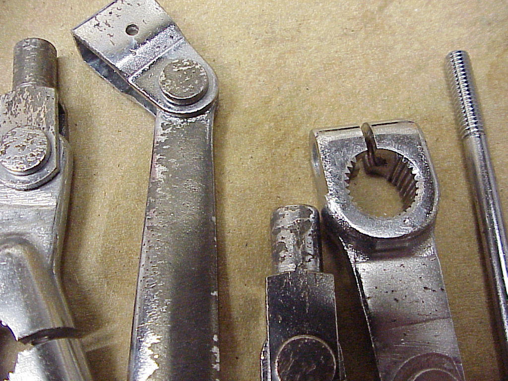

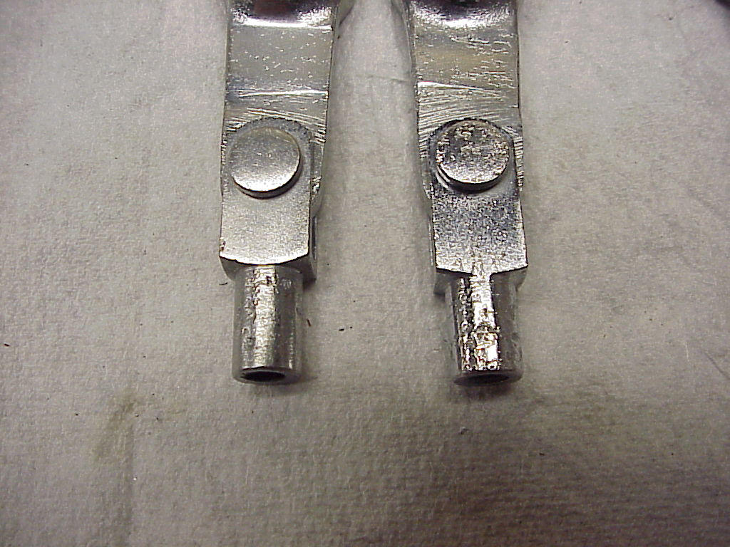

I tried to shoot the before and after pictures to provide a true representation of the parts and the plating. To help with that, let me describe the front brake actuating lever. The polished side (Honda only polished the side that shows) was missing most of the chrome on both legs to either side of the splined hole. Those areas appear dark in the pics because they are raw steel and the rest of the areas are chrome plated. The after pic shows that entire area a bright silver. I did polish that area after plating. I cannot tell where the chrome ends and where the zinc begins because the surface prep for these parts is dismal so even when the chrome was brand new, it sucked. But that turns out to be to our advantage. What you cannot do is take something like a damaged chrome fender, which has decent chrome, and make it look new. But I would say that if you had a headlight bezel with a rusty scratch on it, you could clean off the rust and plate that area with zinc, polish it and only somebody looking for it would notice it.
Okay, that's enough babbling. See the pics for before and after results. I've labeled the pics so you know what you are looking at. Also, because of the way pictures load on this forum, you should view them from the bottom, up, to get the before and after effect. Gotta keep that in mind for future picture posting.
Also note that any dark pits that appear in the after plating pics are shadows. Those pits are all plated with zinc.
