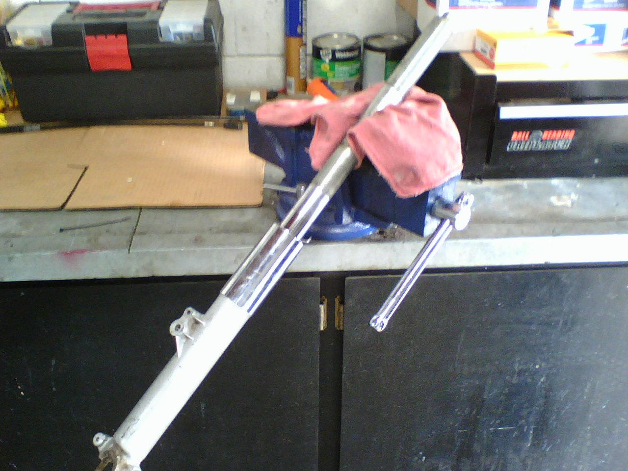

Macgyver5 wrote:So I've recently bought a 1964 Honda Super Hawk and am preparing to do a resoration... As I was going over the bike I noticed that the chrome sliders on the front fork are rusted and on one rusted through I don't know the condition of the inside but I'm assuming that it's going to be bad... What I was wondering is whether or not any of the parts for the forks are available and how hard it it to find the fork bodies... Any advice is welcome and appreciated I'll be posting a pic of the bike and the damaged fork...

Post by Macgyver5 » Mon Oct 15, 2007 4:23 pm
here's what i'm working with now...
Post by LOUD MOUSE » Mon Oct 15, 2007 4:38 pm
OPSSSSSSSSSS! Ya do need to get the chrome off. May be tough but it is just pushed onto the slider with no threads.
You will see a "C" clip in there and that's when ya do what ya are doing now. ..................lm

Post by Macgyver5 » Mon Oct 15, 2007 8:25 pm
any sugestions on ways to get the chrome off?

Post by Macgyver5 » Wed Nov 28, 2007 1:10 pm
I still can't get this chrome piece off... I've tried a strap wrench, I've tried a torch and a welders glove, I've even tried some good ole shock therapy... It's not budging... Any sugestions as I'm out of ideas....

Post by kustommusic » Wed Nov 28, 2007 9:27 pm
Mac, Well if its no good anyway you could use a die grinder and a carbide disc. Slice it up the side,that shoulds get its attention! Kustommusic
