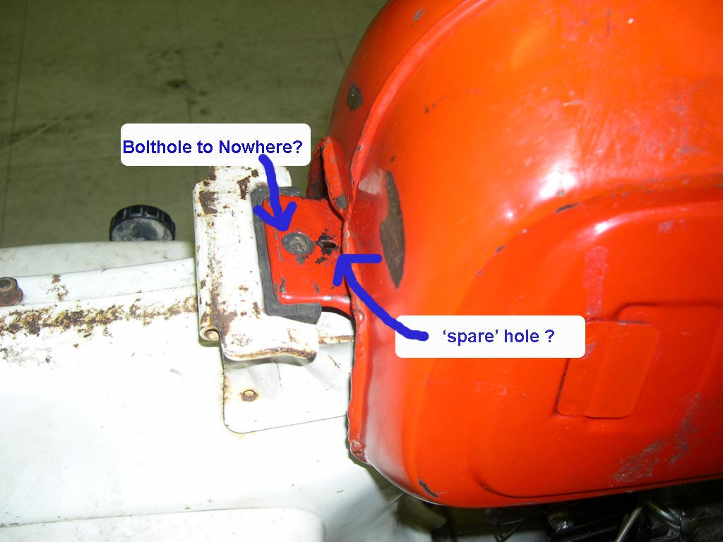

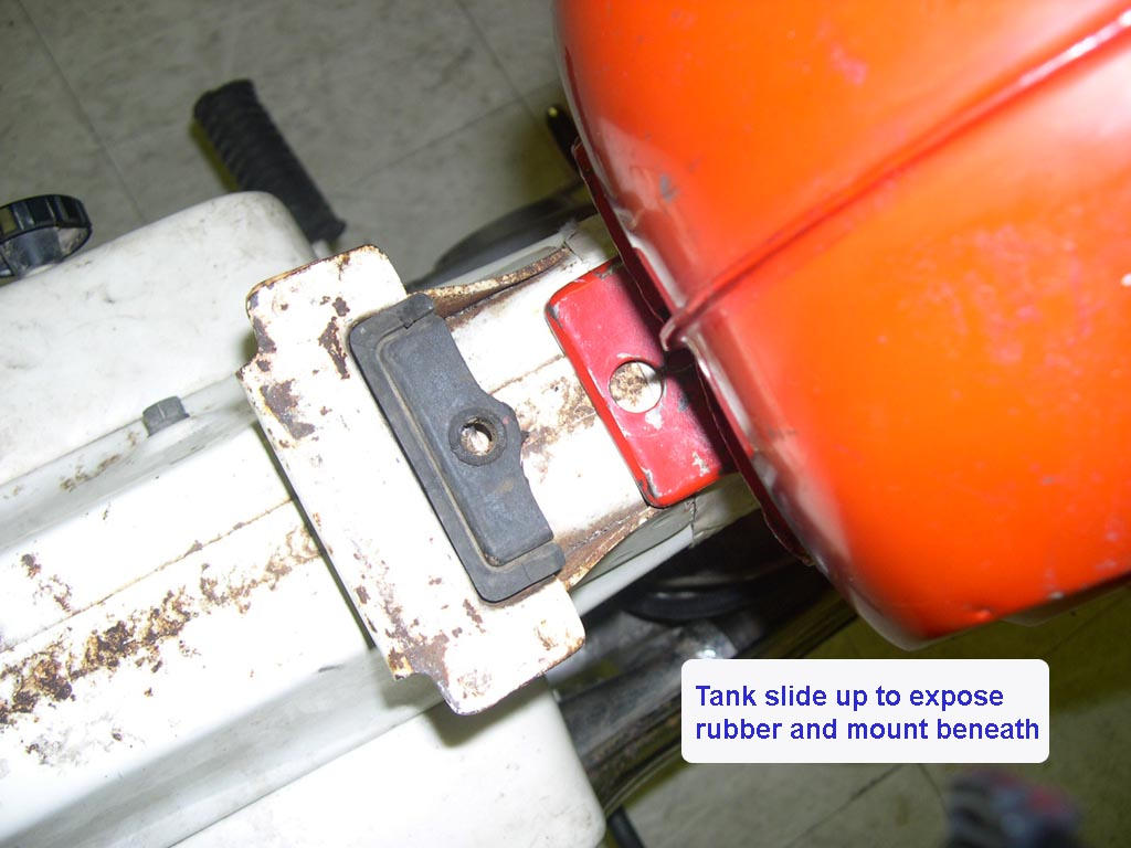

hey bigscoot, im hoping you can help me out here .... or anyone else who might know
after adjusting everything and replacing the plug the s65 fires on 1 kick, purrs at idle, and sounds strong through the rev range. i strapped a board onto it in place of the seat and put about a half mile on the odometer in the back parking lot at work. I was suprised by the amount of power the little 63cc puts out, and at how many days it takes your ass to recover from riding .4 miles on a 2x6 pine seat ( 4 ).
My kreemed tank is cured now, new petcock in place and fuel lines all run. My problem is, how is the tank held onto the bike ? when i look in the parts book it shows a bolt to go through the tab/rubber ... but what does it thread into? below the hole is the solid mount, with no threads. there's a second hole (quite small) in front of the larger hole, but the paint around it doesnt even seem scarred like there's ever been a bolt in it. I must be missing something here .... is there something on the fron of the seat that goes up under the mount that the back of the tank bolts into ? it would almost seem to me though that with the seat in place you lose access to the bolt head. a friend recommended just drilling and tapping a hole in the mount to accomodate the hole alignment, but i hesitate to do any mod's and ruin the originality.
I unfortunately havent got a factory seat for the bike, am in the middle of fabricating one but don't want to proceed if i need to modify the front mount to accomodate the tank bolt.
I've thrown in a few pictures of the rear tank mount so you can see what i'm referring to. Thanks in advance for any help, hints, or possibilities.

bigscooter
Posts: 149
Joined: Sat Aug 25, 2007 5:17 pm
Location: oregon
Post by bigscooter » Fri Jul 18, 2008 1:12 am
hey 3bean, glad to hear you have the s-65 running. there is no bolt to hold the tank down. the tank sits down in the rubber, and the seat has a slot in the front that hooks over it, holding it in it's place.
ultimately two bolts in the back end of the seat fasten to the fender, the front of the seat holds the back of the tank down.
does that makes any sense?

Post by bigscooter » Fri Jul 18, 2008 11:31 am
that's strange. maybe the first year had a bolt in it. i've only seen two of these first hand, but neither of them had a bolt in the tank. i don't think mine has a hole in the rubber. if you put a bolt in it, it should be a shoulder bolt(like the one in the diagram), or have a spacer/sleeve for the rubber to work correctly.
in mine, instead of fixing the compression problem, i put a 110cc clone engine on it. it bolted right up with no mods, plus it is 12v with cdi ignition. obviously i'm not that concerned with originality :-)

Post by 3BeanCrispy » Fri Jul 18, 2008 11:46 am
unfortunately the bolt hole leads to nowhere ! maybe the tank is off of a different year than my frame - it didnt come with it.

Post by bigscooter » Fri Jul 18, 2008 11:47 am
hi again, i just double checked, and my s-65 doesn't even have a hole on the tank tab. your tank and rubber must be from an early, or late model. that's good though, since you might need to bolt it down.
