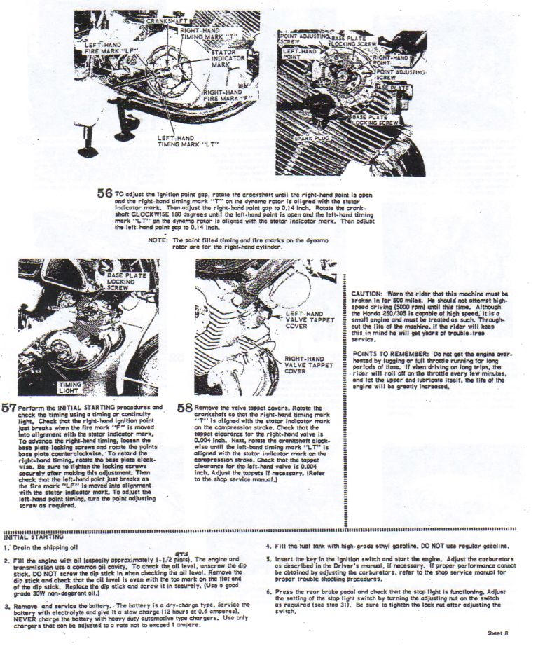

Joe, the following assumes that you've gapped the valve clearances first as a matter of standard procedure:
Take a croc-clipped test lamp; if you don't have one or are, for any reason, unable to fabricate one, get a set of croc-clip jumper wires, cheap as chips from Radio Shack or any electronic hobby shop and, in this case remove your neutral light and use that with a pair of said leads (assuming it lights up!).
Static timing instructions shown herewith in the pic. I've always set the timing with the ignition switch OFF to save the poor little battery's precious capacity: clip one end of the test lamp to the starter solenoid 'hot' stud (or the battery +ve if you have the seat off) and just ground the other end to the motor to test it. If it works, clip the now-free end to the little right points' stud. When the light goes out, the points have opened.
I always take out the plugs so that there's no compression to affect the rotation's accuracy. Make certain that the advancer mechanism returns to fully retarded (acw).
Gap the points first as per the instructions attached. Time the right set first, also as per the instructions. Rotate the rotor with a spanner (wrench) always clockwise, v-e-r-y s--l--o--w--l--y 'till 'F' reaches the timing mark on the stator; move the points' backplate so that the light just goes out, lock the backplate then rotate the motor thru 360º two or 3 times. On the final rotation, check the accuracy of the test lamp's extinguishing with the 'F' mark again. If it's bang-on, move the clip to the left points' stud and follow the sheet's instructions to time-up the left side. If it's off by even a gnat's cock hair, follow the foregoing and repeat until it IS BANG-ON.
Ed, if you're chilled by now, tell me if that's how your book describes your procedure. I don't have a copy of said publication, but I worked this method out for myself when I had my first CB at 16.
Once you've done this Joe, you may now procede to setting your carbs up by Ed´s method. If you can report here that you have carried out the timing to either this method or, if it differs, to Ed's method (He knows more than I), then I'm sure that, once He's calmed down, He will impart His knowledge as regards carb setup (all assuming you don't have His book).
Off you go.....
