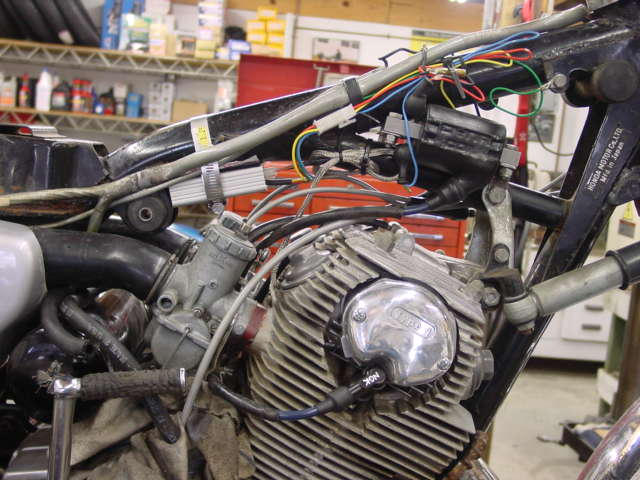

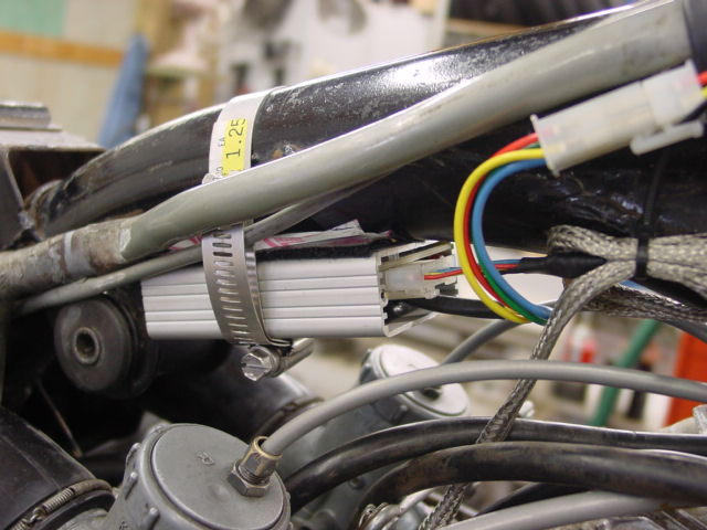

i recently installed the e ignition on my CB77
i made a bracket to install it in front of the battery in between the air filters
i put some heat sink on the side of the e ignition unit to aid heat dissipation
it fits like this
it is nicely tugged in between the air filters but not enclosed so cooling will not be compromised

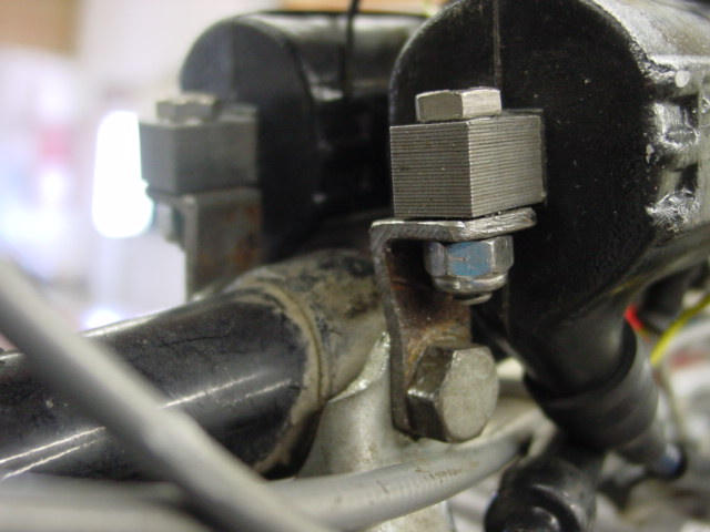

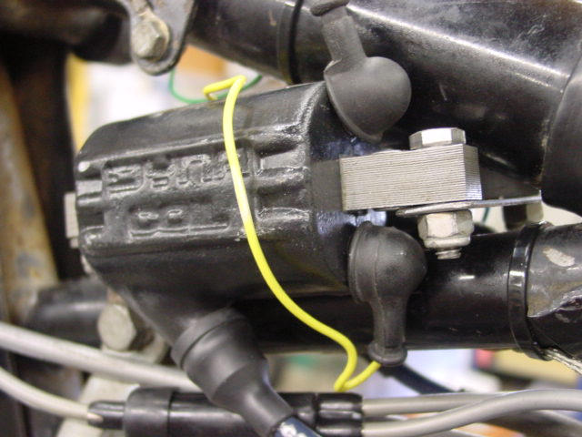

Take a quick look at the front of the tool box and ya can/will find a flat and angular down surface which I attach the brain to. No special parts and in the same area ya installed yours.
Just the way I do things. .............lm
