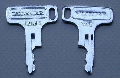

i've tried searching, but i found comflicting info...which of the following keys is the correct original key for code T964x? both sellers are telling me that the keys they have pictured are genuine honda NOS.
