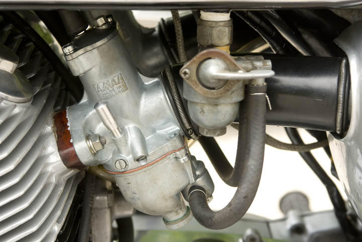

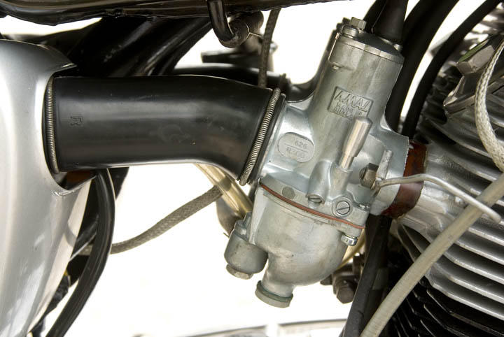

Here we are again....
Picked the bike up today and took 'er for a ride. Runs fantastic! The throttle is heavier due to the stiff springs in the carbs, but WOW! The one thing is that these carbs don't like to be snapped, but prefer to be 'rolled' on. As well, these carbs have had their chokes removed, but they can be reinstalled if needed, but my mechanics determined that I don't need them. Here are the numbers as they came out of the box: Amal 626 (26mm), 160 main, cutaway throttle valve 3, 106 Pilot, standard Amal needle. They mount up with no problems as you can see, and look totally appropriate on the bike. Cold starting requires that you 'prime' each side using the plunger located on each carb...just keep pumping until you see gas coming out of them. Crack the throttle slightly, hit the start button and there you go. So, for those of you who are tired of your worn out Keihins and aren't concerned about OEM carbs, these babies are the ticket! Thanks to Phil in the UK for the suggestion!
