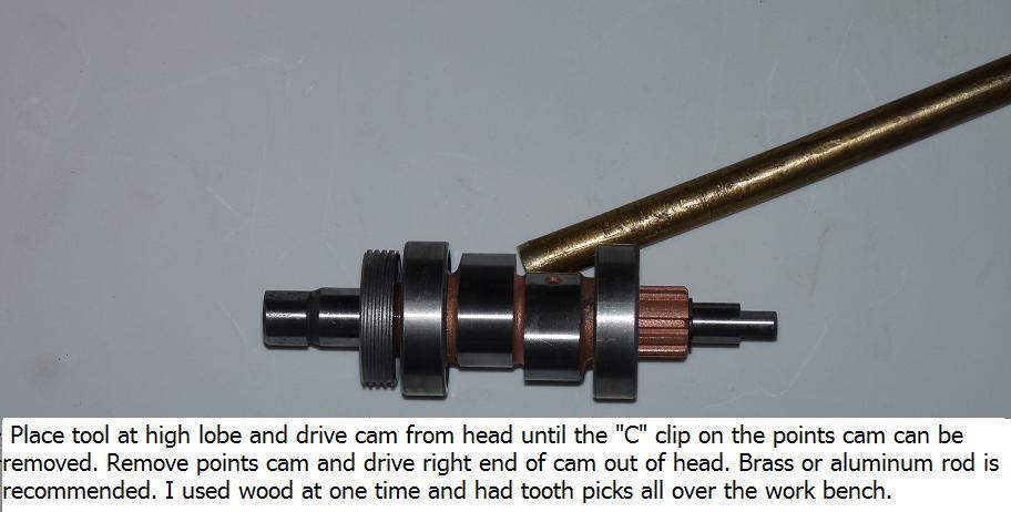

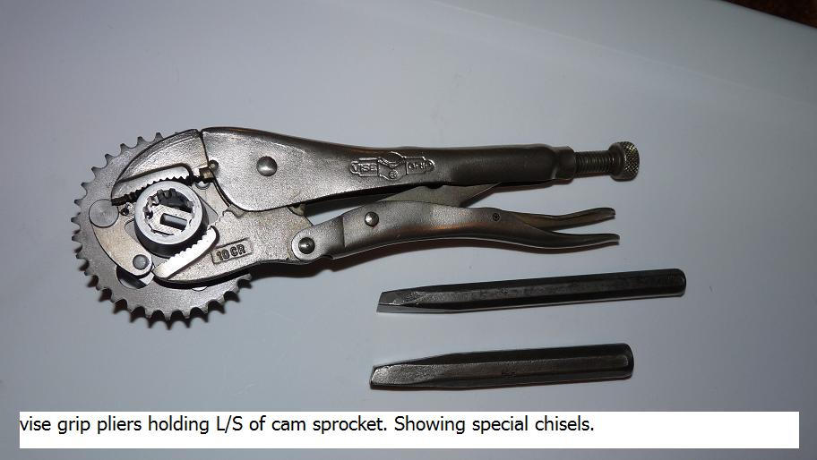

I have attached several pics of the tools I use and how I use them.
The steel chisels can be used at the crank nut also. ...........lm

The J.H. Williams Tool Group offers a high-quality 3/4 - 2" adjustable hook spanner wrench (their number 471) that I use for the crank nut and the camshaft drive nut. No, you can't torque to "exact specs" using it, but it will provide a good alternative to the dull chisels, gripping the nuts securely, without marring the parts being loosened and tightened. Regards, Chase
