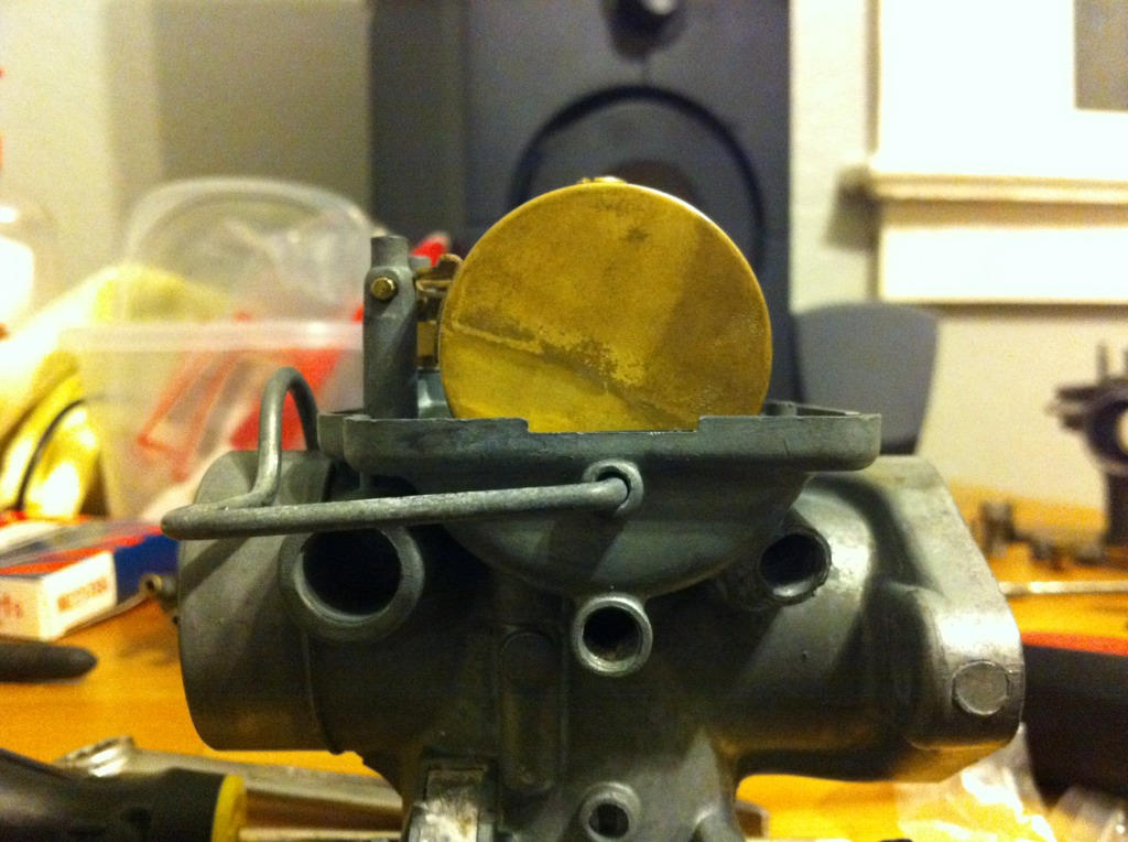

Post by marlin4622 » Tue Nov 09, 2010 8:41 pm
so i am assuming that this is correct level..

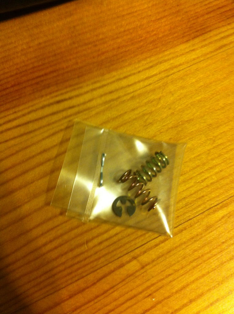

also... does anybody know what this little clip is??? i did not reveal this little clip while the tear down of my carbs....

mysterious clip???
mysterious clip???
proper float eyeball level??

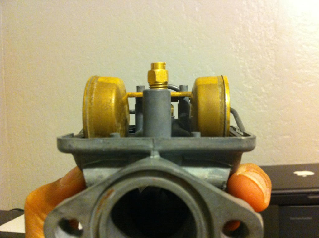

Post by marlin4622 » Tue Nov 09, 2010 8:49 pm
side view..
im afraid that the floats are too low...
i am judging by horizon at the base of the carburetor. where the gasket lies. I make that as straight as possible and then look to see if the main jet housing is in view... or am i suppose to judge at the top of the floats??
thanks
side view of carb
side view of carb
Dgormley
Posts: 405
Location: Tacoma Wa
Floats
Post by Dgormley » Tue Nov 09, 2010 10:07 pm
Marlin, If ya flip that thing upside down and try to think of its' intended purpose it may become clear to you what your doing. That little clip is the jet needle clip( holds the jet needle in position in the carb slide) if you do a search in the carb section there's some real good graphic examples...............D
