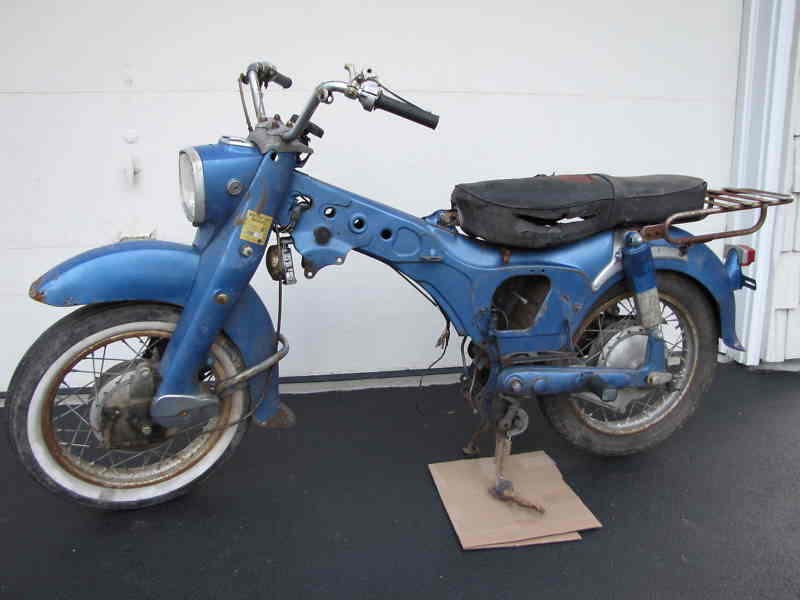

the shorter fender braces/shock supports are correct for your frame #, 62 ca77. bike should also have the center fill tank. welded taillite, clamp on mirrors, grey front fender gasket, as well as other minor differences from later dreams
Randy
Post by brewsky » Sat Nov 20, 2010 2:48 pm
Dr. Frankenstein wrote:Okay, here's what I found: the frame # is CA77 - 22812
The engine number is CA77E - 212872
The drive sprockets are located on the right side
BUT: it has the shorter CA95-ish rear shock supports, and no 'ghost' image or screw holes or whatever to indicate it ever had the longer shock supports...it looks like a ca95 rear fender..
So it looks like I have a CA77E with CA95 shock supports....??
Somebody along the way also painted the bike another shade of blue OVER the factory blue, and also painted the chrome headlight ring and shock supports silver - I have no idea why...maybe they were going for an 'anodized' look...
Note: somewhere along the way it also got crunched - there is evidence of brazing on the front fender, and the rear fender is slightly bowed out, as if something ran into it from behind...perhaps somebody replaced the rear fender with a CA95??

rrietman: Ohhh, so it's a '62...man: nothing like an antique bike to make you feel old, esp. since *I* was born in 1964! My parts are getting hard to find, too....:)
e3steve and brewsky: thanks for the tips, guys. Let me see if I can't add something now:
Hopefully I'll be able to post pics of the other one I painted with spray cans...
FWIW, brewsky, you live right over the mountain from me...I'm down near Charlottesville...
The (apparently) '62 CA77 I just got:

I'll keep working on it...right now life is getting in the way, so I'll have to come back to it...in any event, that blue one is the newest Dream I have...apparently a '62..thanks ya'll....
