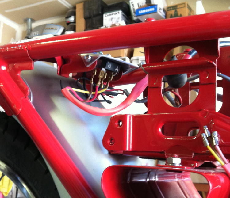

My version: heat sink is a square of Aluminum with the corners bent and drilled so it mounts in the original spot. This provides 2 points of ground, a tad more cooling, and easy access. Rectifier is mounted upside down. If I need more cooling, I can easily add a small fan to the top.

Post by brewsky » Tue Apr 12, 2011 12:38 pm
Hmmmmmmm.....looks suspiciously similar to those little reflector mounts the state puts on the side of the road so you can see in the dark....they do come in handy!
Make excellent kickstand pads also.......at least I've heard that!

Harrumph! ... cut from stock dontcha know. Although I do want one of those red STOP signs in my garage cuz it matches my scooter (almost).
