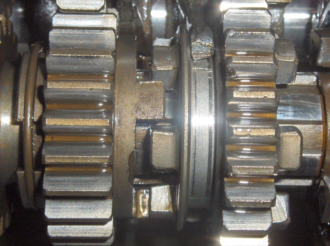

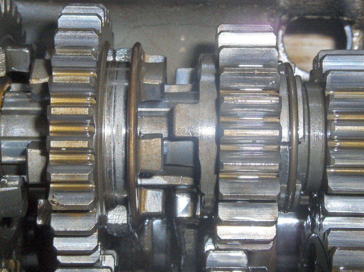

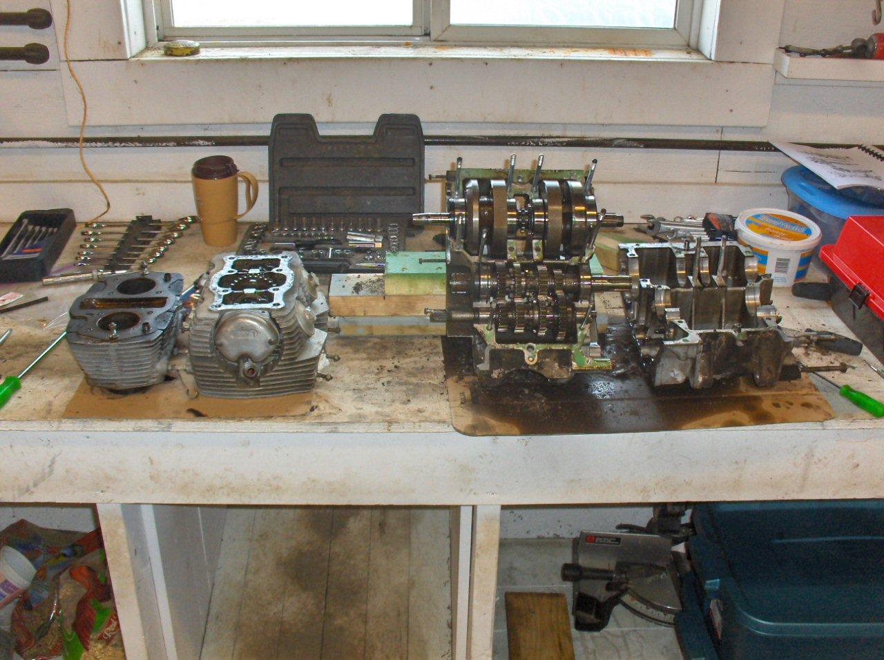

Haven't posted for awhile. Wifes' been keeping me busy with "spring renos". Got the bike pretty well tore apart. I need your opinion on the tranny gear dogs. Too rounded off or not? I'm hoping that a set of offset cotters will do the trick. It looks like I just have about 50% engagement now. Where is the best place to get those cotters?
I have the 14mm bushing and will replace that.
I will also need .50 over piston rings. Any suggestions other than e-bay?

The trans looks OK from what I see. .......lm
