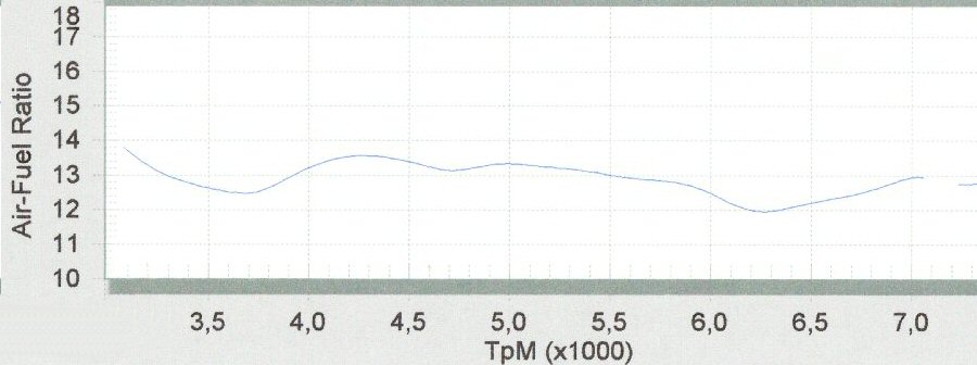

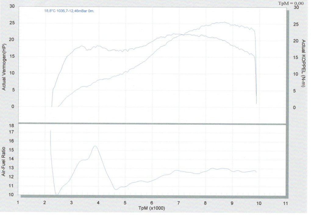

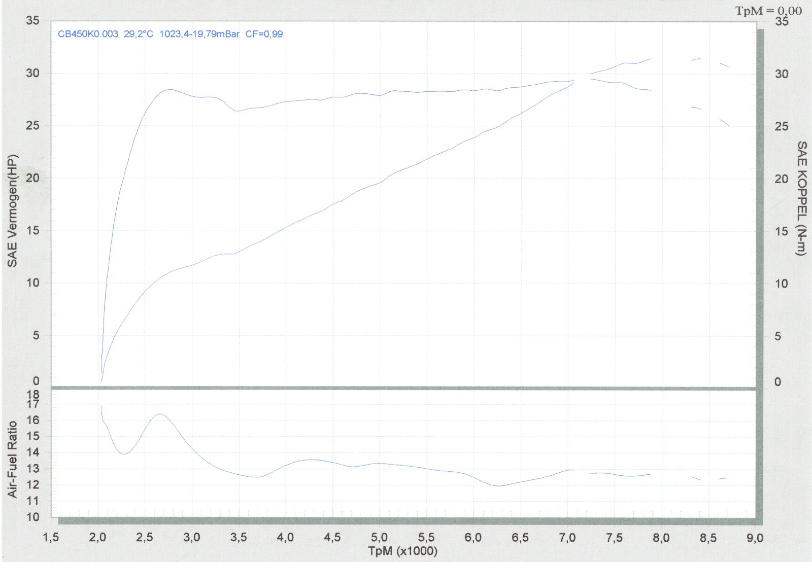

This is a run from an old post, it's done with moderate temp and "normal" pressure.
It shows that I never get the A/F ratio above the 13, and lowering to 12.7 at the redline.
The bump untill 5000 rpm is introduced because the throttle opens to quickly, it isn't a constant vacuum carb. The second run is from my bomber, and you see that the bump is much smaller now.
You see that the max rpm with the dream is higher then the bomber.
This run did cost me 50 euro plus working time (of myself) to change needle hight and / or jetting. The point is, when you found a good setting, and it runs well, you don't have to touch it anymore, unless there are problems, and that for 50 euro and no hassle.
Notice the small gaps on the CB450 run at the high rev's (7000 to 9000 rpm), these were introduced by a not so good condenser. Without noticing in this run, if would have destroyed my points (burned). Also notice that the bump still exists, but less then on the dream. Later, Honda did a modification on the carbs by putting in a spring above the valve, mine doesn't have that spring, but you see clearly why Honda did the mod.
Jensen
Dynojet A/F Meter

I'll try to explain were what works on the CB450 A/F curve first, because it's a CV carb, and gives a better understanding what happens.
The process is as follows. The bike is on the dyno and warm. The run starts as low as technical possible, in this case around 2000 rpm, lower isn't possible, remember, the run is done in third gear.
During the run the throttle is opened controlled, from stationary to WOT, remember, it's a CV carb, you can do that, the carb is regulating itself more or less. The engine is on a dyno, and has to deliver, so it has to work, work hard.
You can see here and here how it works and sounds
To keep it simple, in a carb there are four different sub systems working, the stationary system (stationary jet), the slide, the needle, and the main jet.

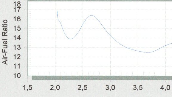

Looking at the partial AF curve 1 :
Systems working : stationary jet, slide angle and straight part of the needle.
Throttle opening : 0 to 1/4
When the engine is idling, the stationary system, together with the slide are in control, this is the area from 1000 rpm to 1500 rpm. When opening the throttle the air is sucked in, and because air is sucked in first (the gas is slower), the engine will run lean (see the peak around 2500 rpm). The needle is straight in this area, so is only metering a constant flow of gas while the slide is moving upwards.
Looking at the partial AF curve 2 :
Systems working : straight and angeled part of the needle
Throttle opening : 1/4 to 3/4
Around 3000 rpm, the needle starts to get smaller and letting in more and more patrol until the engine is running on the needle only (from 4000 rpm in this case).
Between 3500 rpm and 7000 rpm the needle is metering the gas, and around 6000 rpm the main jet is coming in.

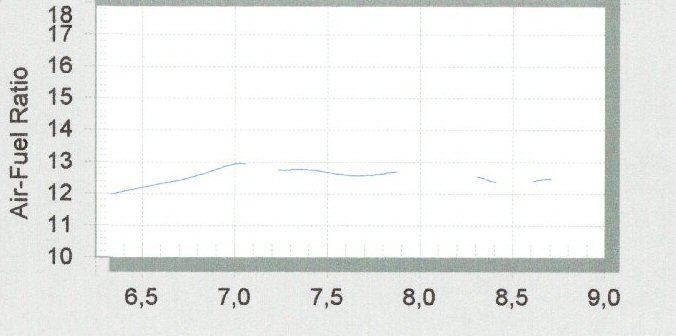

Looking at the partial AF curve 3 :
Systems working : angeled part of the needle and main jet
Throttle opening : 3/4 to WOT
At 7500 rpm until 9000 rpm, the main jet is mainly in control, starting to take over completely after 8000 rpm.
I explained something about what you can see in the curves. The word power, and max torque are not used by me until now, and it is a misunderstanding that a dyno is only to measure power.
btw, I excluded the influence of the float hight, actually I excluded more, because I like to keep it simple.
Now, when you look at the complete picture, you will notice that the torque and power curve are reacting on the A/F curve. Please notice that there is a small time gap between the A/F curve and the power curve, this is due to the fact that gas needs to get to the sensor, which is a few meters (and thus time) away from the combustion chamber.
You can distillate so much info from a simple curve, that's why I like a dyno run every once in a while, it shows if everything is still working as supposed to.
Jensen

On the C78 it was done slower, proportional to the rpm, because of the direct slide.
