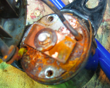

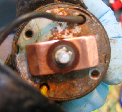

hey tom, actually i did take it apart very thoroughly and cleaned it, it had quite a bit of rust in it, after trying to clean it and then put it back together, it still didn't work, so thats when i bought a new one. here are a few photos of how dirty it was.. thanks so much for the offer though!. you rock.
