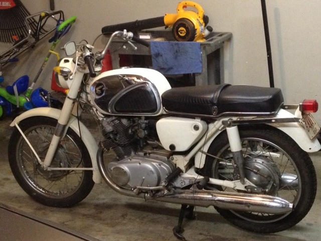

Why, do you mean this?
(I hope the image shows..newbie and all)
Snice this is my first post. I guess I need to introduce myself. Names Brian, Ive been a longtime forum stalker. I couldn't resist replying when I saw this thread. This is my second SH. My other one is a restored red '65... I'll post pics of that bike later.
The story with this bike. Sellers father purchased new, she is actually a 1964 going by the wire harness. Looks to have been stored in a barn in Ohio. Father passed and it went to his son where it made its way to Baltimore around 2007. Tank badges are original and flawless bakelites!! The only thing I can see missing at this point are the grab handle and tool kit :( Grab handle missing because the bike had hard bags on it at some point. It's all there and a true white superhawk. I have taken everything off in an attempt to find a respray. Its all white..even the tank hold down. Tank was 1/4 full with 20+ year old gas= a rusty mess. Curently cleaning tank up. Wire harness is not hacked up. I plan to keep this as original as I can. After all they are only original once. The winkers are off (period aftermarket) The high bars will be difficult to keep. I'm not a fan.Image

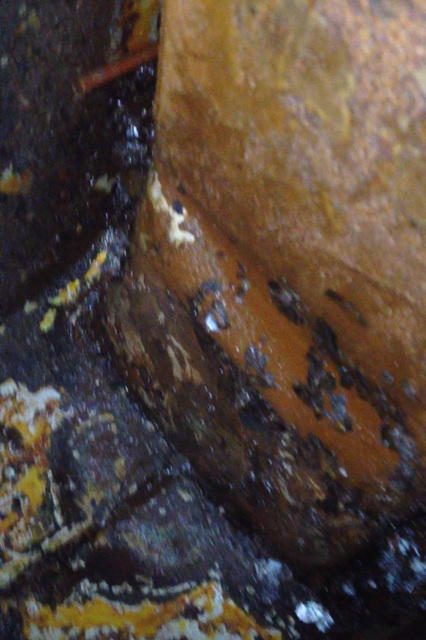

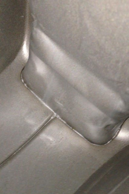

Congrats Pelayo!! Very nice looking find. I was checking out your pics and it looks like the tank is cleaning up nice. Mine was an absolute mess. 4 treatments of Muriatic acid and it still had varnish in spots. The POR15 kit cleaned up the rest and now it looks bran new.
Lets see if I figured out this picture attachment thing...
2_Hawks
Posts: 27
Joined: Thu Apr 18, 2013 10:08 am
Location: Baltimore
Post by 2_Hawks » Wed Apr 24, 2013 9:46 pm
Here's a before and after of the tank. I can't say enough about how awesome the POR15 kit is. I used it on my red 65' CB77. A little time consuming but well worth the results.
