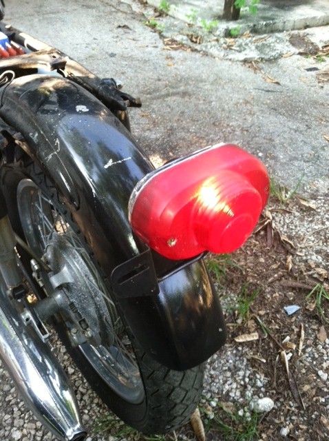

And for he who requested it, here is a shot of the taillight.
The passenger pegs are non-folding. The motor # is CB77E-10548xx. The frame is CB77-10547xx
The tag on the wiring loom under the tank says 1966. Having consulted threads on here, I am now wondering what someone would say is the year of manufacture? I know what I found, I want to know what others say. Opinions, please.
