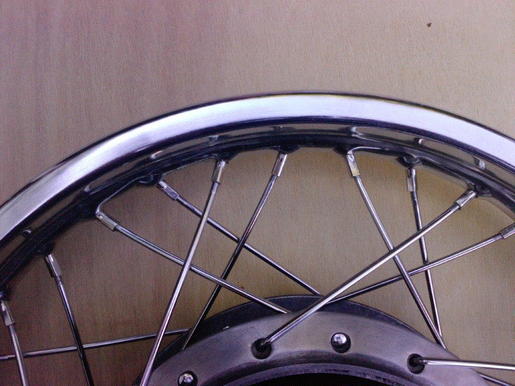

today i had check with honda dealer they said c77 hub bigger and curve spokes head need more curve to fit not ordinary spokes your local bike shop say it's true but original spokes head was bend more curve i will check with www.cmsnl.com but i can garunteed rim universal standard if you not believe me pls check again

Answer: Mike, those wheel/spoke kits are a disaster and they won't make them right, apparently. If the rims are 1.85x16, they are really for a C95 Benly, not a Dream. The spoke holes are drilled incorrectly for Dream hub widths. I don't have any close-up photos of Dream wheels/spokes at the moment, or spoke length dimensions.
I would contact Central Wheel in the UK and see if they can re-drill your rims, if they are the correct width. If they are not the correct rims, then you are fighting a losing battle.

It,s his fault all along, ad states clearly C77.
This is the result, can it be clearer?

dohcmike wrote:It,s his fault all along, ad states clearly C77.
Even send him more pictures than this one.
