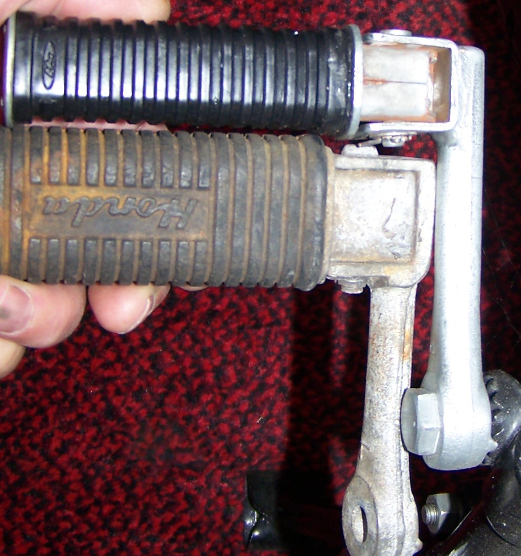

As I recall the pic it showed the mount with the bolt hole right at the shaft end not the ones the CL72/77's use. .........lm
Buck wrote:OK, looked at mounts. Early peg mounts measure 26mm wide and late models measure 21mm wide where footpegs slide in. Parts book says #50721-273-000 for bikes up to S/N CL77 1047052 and #50721-273-010 for S/N 1047053 and up.

Post by Buck » Sun Oct 30, 2011 8:05 am
These are the early and late model mounts.

Posts: 7817
Post by LOUD MOUSE » Sun Oct 30, 2011 8:10 am
???????????????????. ...........lm
Buck wrote:Here is a picture of the early model and late model mounts.
Posts: 7817
Post by LOUD MOUSE » Sun Oct 30, 2011 8:55 am
I do wish jbills would show that pic again.
I know what these are and can tell ya there a couple of different castings at the frame mount end.
These are not what I saw in the original pic.
The ones I saw where for a DREAM as they had the DREAM mount and in case it helps the DREAM rubber were at times shorter than the CL72/77. ....lm

Post by Buck » Sun Oct 30, 2011 9:01 am
OK, The way I read this was that no CL models came with large passenger pegs. Glad we cleared this up. Buck

Post by LOUD MOUSE » Sun Oct 30, 2011 9:18 am
Not true.
The ones ya show are correct for the CL72/77.
The ones jbills showed were mounted to the DREAM mount which wasn't as stated. .......lm

Post by jbills » Wed Nov 02, 2011 9:30 am
I did originally show the larger style passenger pegs for a CA77 not a CL77. I have a set of CL77 passenger pegs with the larger rubber rests but mistakenly put up the CA pegs. Sorry about all the confusion.
