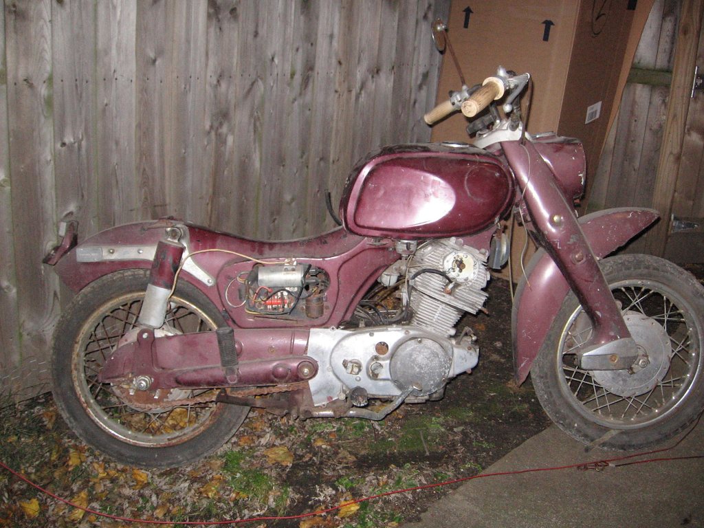

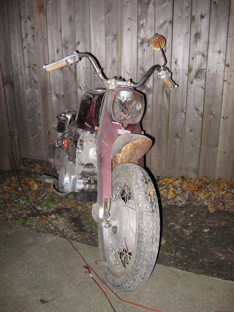

First bike and first restore project. 64? CB77 Superhawk

frame number
Frame number #1001779
engine CB77E #1005354
Any ideas?
Any ideas?

According to your frame #, it's a '65. The engine # isn't close enough to the frame# to be original to that frame, although it is most likely a '65 as well. The bike could have had an engine swap, or the engine could have had a case swap. Even from the factory these numbers rarely (if ever) matched, but were within 200 numbers of each other. Don't be too concerned about the numbers, many of these bikes were used heavily and it is common for the frame and engine numbers not to coincide.
