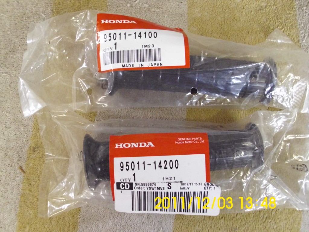

48lesco wrote:Those are both the same according to the picture and not the right part number. They may well fit the left side of all those bikes listed, but not the throttle tube on your '65 Dream. You need Honda part number 53165-271-000 or a reasonable knock-off. I think its 1-1/8" dia and with a little grip cement, will slide over the throttle tube without much effort. I would give Ohio Cycle or Western Hills a try.
They are not both the same. I email'ed the guy before I purchased to confirm that one is larger than the other. I'll measure them tomorrow, but I believe one is 7/8" to fit the left and the right is around 1", but I'll double check. I'll look at the part #'s also as they came in sealed Honda bags.
I believe he had the wrong part # shown(30370-300-020) with the grips as everything I've searched shows that part number as a points cover.
But I do believe you are correct in that a grip closer to 1 1/8" would be a better fit. Ohio Cycle lists the part number you reference for $45(ouch).

Here is what I purchased. In searching these part numbers they fit a wide range of MC's, just not the CA77 with the twist throttle.
The left measures approximately 7/8" and the right 1". The part number the ebay dealer has listed is not what he is sending out.
