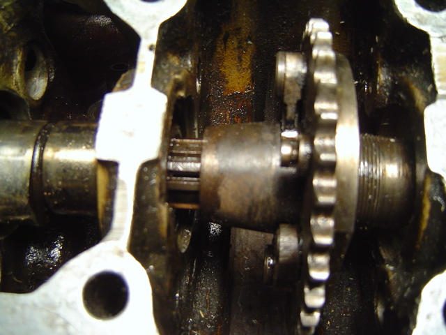

Thanks for the info, however, I have already done this. I have hit the nut on the end of the left cam shaft which pushes the left cam shaft into the cylinder head and there is no space then to angle the cam sproket and the left cam shaft with bearings to pull it out of the center of the cylinder head. (See Clymer manual descriptions below). I also have the Silver books and there is almost the same description there. Step 3 and 4 infer the separation of the cam sprocket from the left cam shaft.
My question is, does or is the cam sproket supposed to separate from the left cam shaft?
This will then allow for the let cam shaft to go outward and the cam sprocket to be loose in the center and easily removed.
According to the books it is supposed to come apart and out. The two bearings remain on the camshaft. If I strike the nut on the outer left cam shaft back into the cylinder head, I then a have to pass the outer bearing through the inner bearing hole and by then the cam sprocket is now up against the other side of the inner center wall of the cylinder head?????
Am I not looking at this correctly?

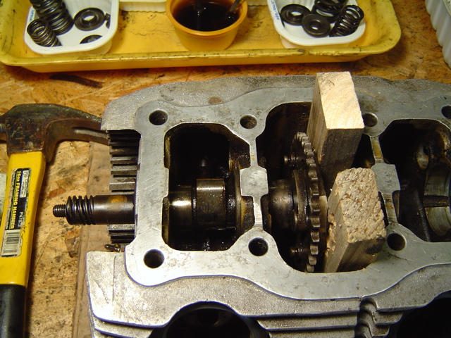

Therefore I put some wood between the camshaft (turn the camshaft so the biggest part is up) and the cilinderhead frame. Then you can hit the axle and the bearing won't slide out.

I have tried various times to strike the left camshaft with the 8mm nut at the end of the threads but it only pushes the left camshaft, bearings, and cam sprocket into the cylinder head. The cam sprocket does not come loose from the shaft. I am very frustrated. If someone had any other suggestions, I would appreciate it.

yes the sprocket does indeed separate from the left half of the cam. i needed to switch to a small metal sledge to free the bolt expanding the end of the left cam onto the sprocket. once this bolt is free inside the left cam, you should be able to get the cam sprocket out.
im a visual person so i drew you a picture of the setup i used to get mine out. hopefully it helps you out. basically you need to brace the cam from sliding around in the head when you hit it. this way, maximum force gets transferred to unsticking this left cam bolt.

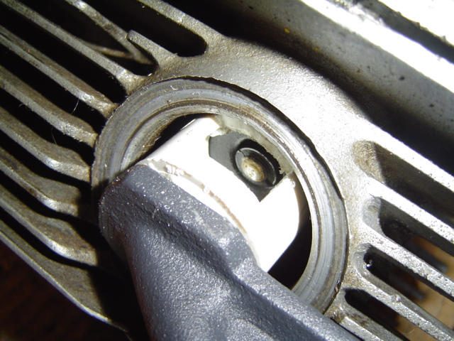

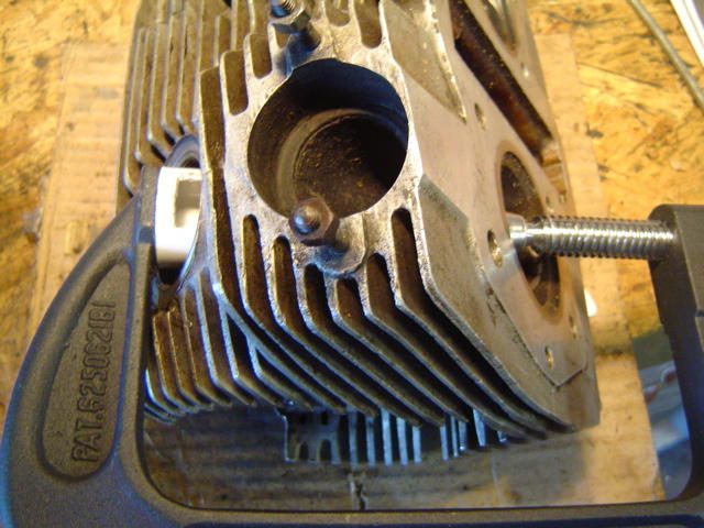

Left Camshaft Removal retry
Thanks for the drawing. I was finally able to get the cam sprocket to release and removed all the parts. I adapted your method. (See photo)
