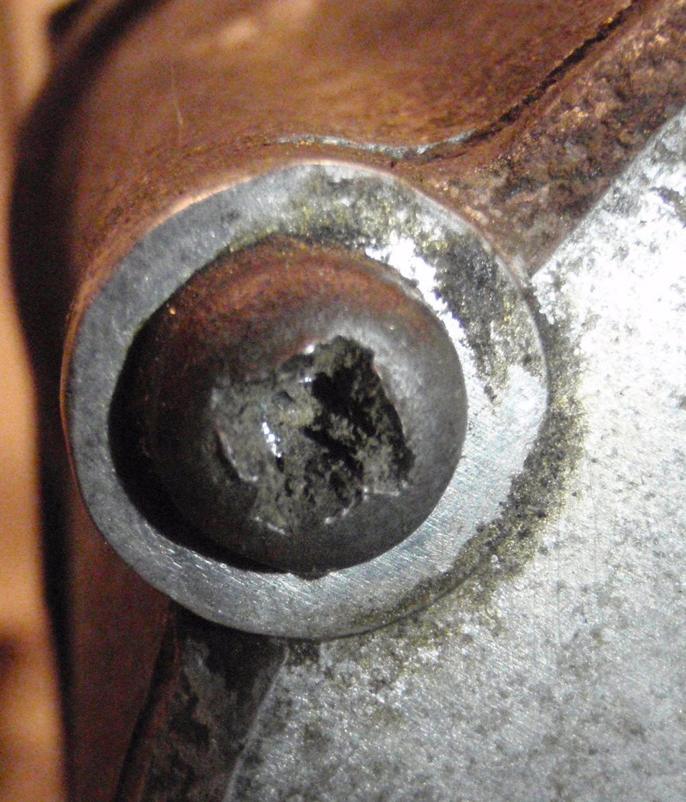

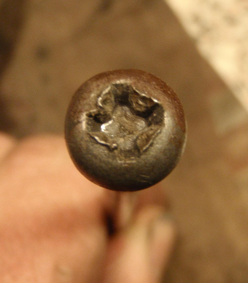

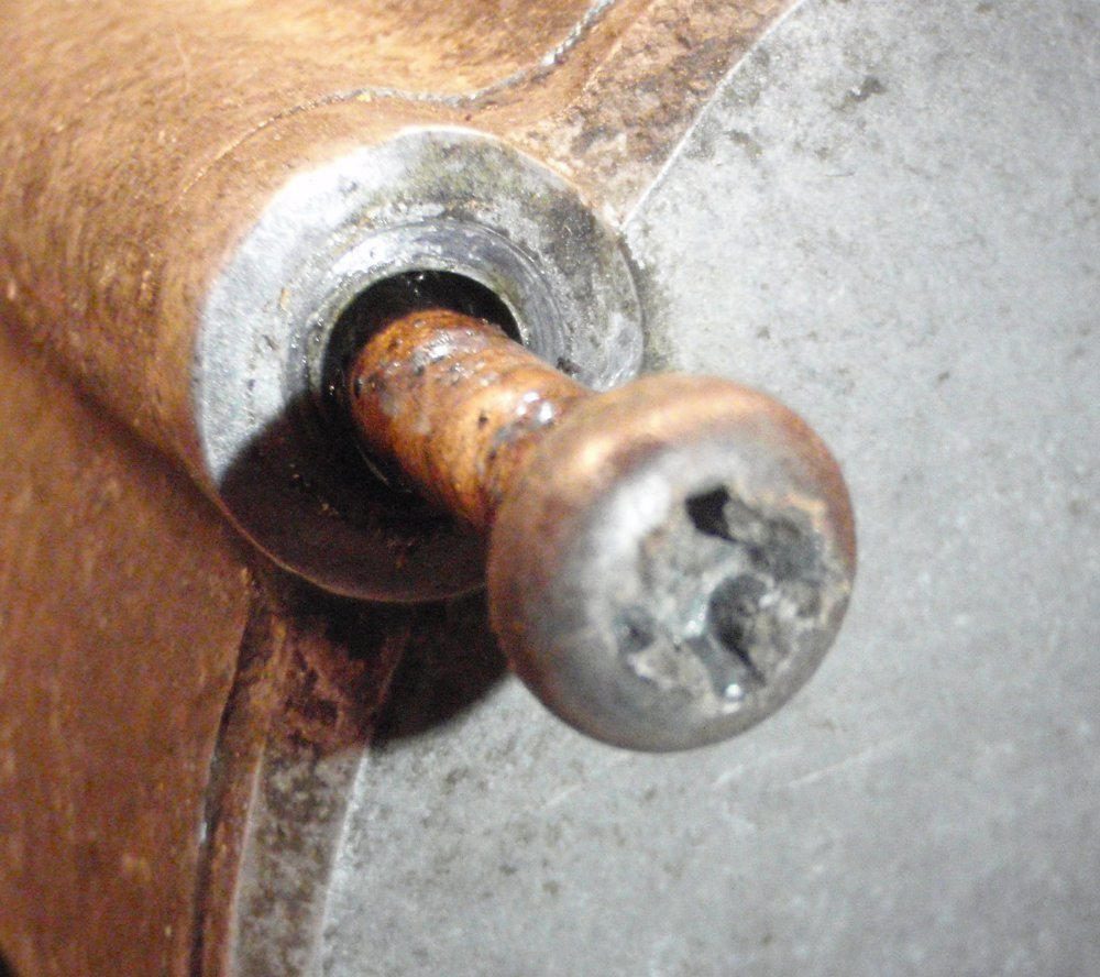

This screwdriver also works on really butchered screw too, see the attached pictures
I cleaned the screw before using the screwdriver, lot's of dirt in in too.
Unfortunately, this screw is lost (beyond repair). It's a very long one, and has a special length (CB72 Oil filter cap screw).
btw, I never clean an engine before disassembling with a high pressure cleaner, you will be surprised where the water comes (did it once, but never again).
Jensen

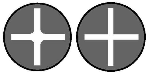

In my experience when you use the screw once or twice, the JIS will have the same shape as Philips if you know what I mean.
look here : http://www.webbikeworld.com/motorcycle- ... ewdrivers/
and for those who want instant result, see picture, Left is Philips and right is JIS,
Jensen
Yes, it does, it's a coating and doesn't have eternal live, it wears. I used the nr. 3 heavily about 2 years, and it won't do another 2 years. I guess you can use it on 1000 difficult screws or so, but it's wild guess.Does the coating eventually wear off?
I'm sorry, no.I also noticed they have other tip options such as "laser" cut and "black point", are you familiar with either of those?
Don't know, I bought these two years ago, and bought them again two months ago as a gift for a good friend in the US, no problem in ordering.Also, I can only find the diamond coating on the bits themselves and not in the drivers as you show? Maybe the driver option has been discontinued?
No, just like the title says, Philips. I never said it were JIS drivers. In general, the differences between JIS and Philips are not that big. Look at drawings between both, and you'll see that the only differences are the rounded curves in Philips and the straight edges in JIS.And lastly, are they true JIS shape? I can't seem to find any reference to that on their website.

Thanks for the reply, Jensen.
I was under the impression there were more differences than just the rounding.
See here:
http://www.instructables.com/id/When-a- ... -Standard/
I do know that NO screwdriver I have used, even those claiming to be JIS, feel like as perfect a fit as the OEM from the toolkit.
The Motion Pro T handles feel pretty close though, and are supposed to be JIS.
