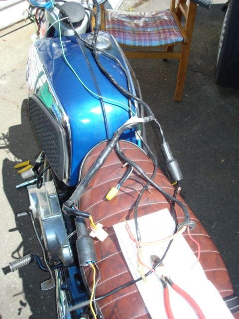

I pulled the wiring harness, unwrapped it and tested, everything lovely-fine.
Still no joy. Hmmm?

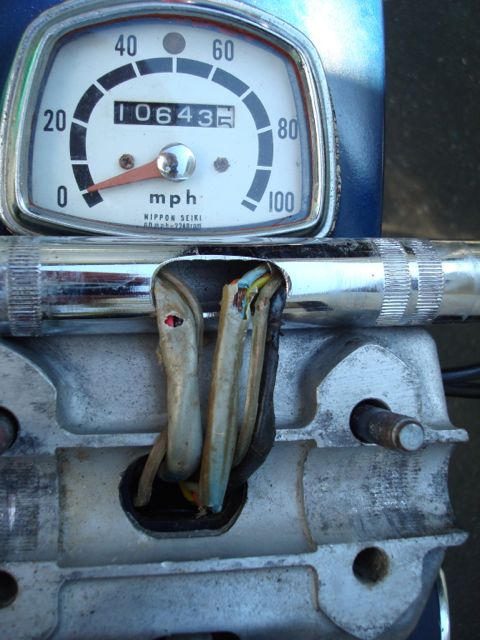

Then I checked the wiring in and to the handlebars. Multiple exposed sections, lost insulation. Looks like I've found my problem. I'll post a pic or two when it's sorted.

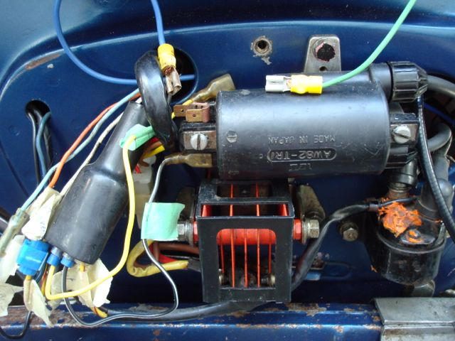

I went over all my wires and connections, fixed umpteen current or future problems. But I get no spark at plugs.
There is 12V at both + and - small terminals on coil (when points closed). Until the green line to condenser/points is connected, when I loose power on - terminal. That doesn't seem right...there's no power to the points to do static timing, let alone start the motor.

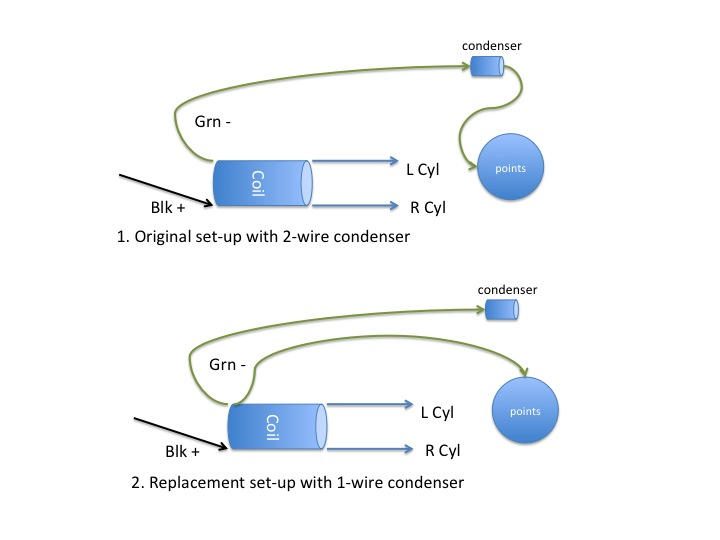

Figuring this means bad condenser, I tried two others I have on hand (both seem to be for CB's). I tried using just one side of the OEM version (it has 4 wires, I used one side), and I tried an aftermarket picked up online (the kind with one yellow and one blue line, which looks to me to be two small 1-wire condensers). I also checked continuity, even replaced all wires in-between.
Something un-good is obviously happening when I connect the green. The new condenser is mounted on a steel bracket to the top engine mount bolt, so it's grounded. I've checked the points and plate, when energized it properly opens and closes the circuit.

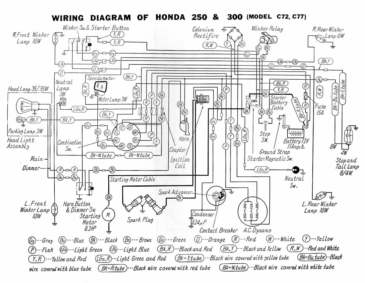

You won't get 12V anywhere with the green wire hooked up and the points closed. What you have then is essentially a short circuit through the primary winding. Study the wiring diagram (I attached one if you don't have it). You get 12V across the points when they are OPEN and that's what makes the static timing method work - points open, light goes on. On the CA77's the condenser case MUST be grounded to the engine.

40K is a little higher than I would expect, but may be OK. Check resistance across the other two leads (primary winding). It should be in the single-digit Ohms but not zero. The coil in the picture is not OEM Honda and therefore you're a bit into uncharted territory. When you check for spark, both plugs have to be grounded - I would just screw the other side in to ensure a good ground. You should see spark on the other plug as you break the primary (black wire) circuit.
