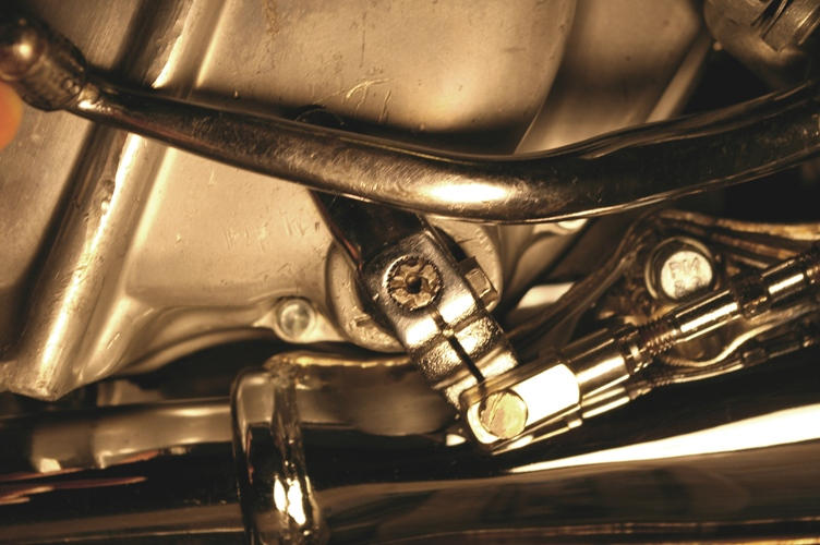

So, I'm trying to understand my shifting difficulties and I don't want to hijack Spargett's Restoration Log with more questions about my machine. I did reply to one of his posts about my difficulty in finding 2nd gear and wondered if my shift linkage was set properly. LM responded saying the shift arm should be indexed at 11 o'clock. That's where we left off and where this line of discovery continues...
I think my shift arm points to 11 o'clock but there may be time zone differences between Texas and me :) But how is the arm indexed? You can see in the pic that the shift shaft end is pretty mangled and has denied me a definitive punch mark. I can put the arm on any spline I choose but without marks I'm nowhere. Are there marks showing in the pic that I'm not seeing?

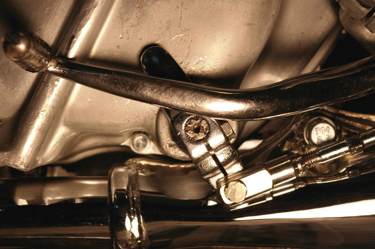

I wonder about the free-play in the shift linkage. The first pic shows the shifter at rest, and the second shows me lifting the shifter up to its point of resistance. The freeplay at the toe rubber is 5/8" (160 mm). I'm not sure what it should be, if anything at all.
At this point I don't know if my shifter shaft/linkage adjustments are the cause of the difficulty or if my shifting technique is no good. These are the symptoms:
1...difficulty shifting up from 1st to 2nd--I seem to arrive in neutral, and then when I try again, at lower rpm's it will shift. Downshifting from 2nd to 1st is fine.
2...for the life of me, I can't easily get into neutral from 1st. I don't get a neutral light and I have to stall the engine and then rock back and forth shifting up and down between 1st and 2nd in order to finally find neutral. It seems easier when I go from 2nd down the half-step to neutral than when I try going up from 1st to neutral.
In summary, my shift shaft indexing may be incorrect; my shifter linkage adjustment may need tweaking; my shifting technique may be wrong. Or maybe my clutch is not adjusted properly??
Any suggestions would be gratefully received.
