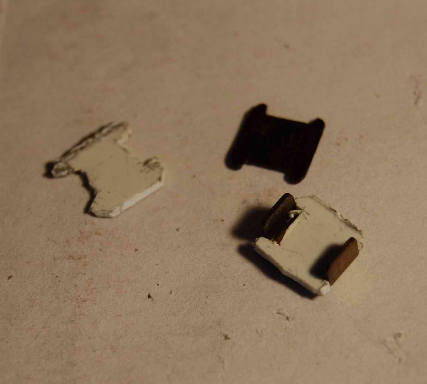

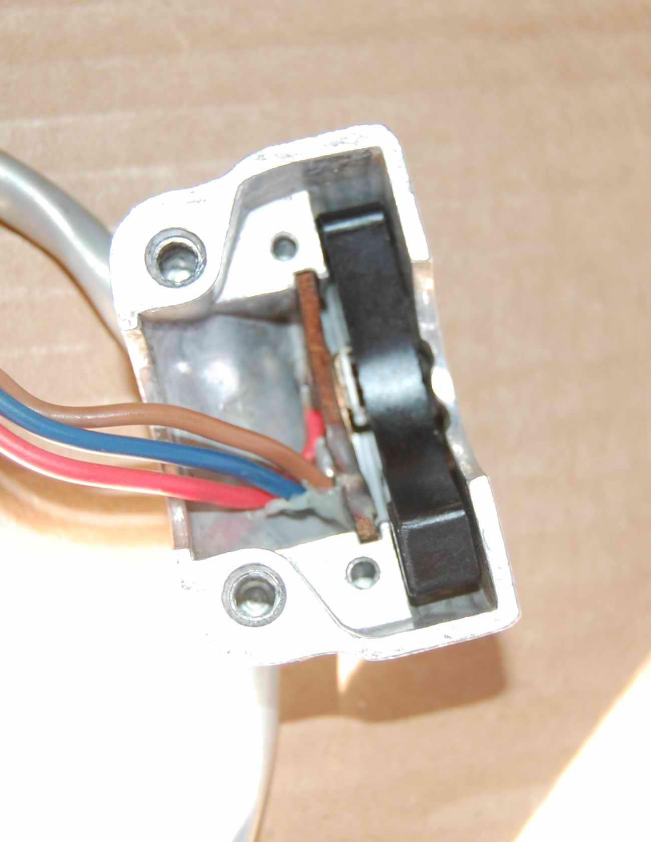

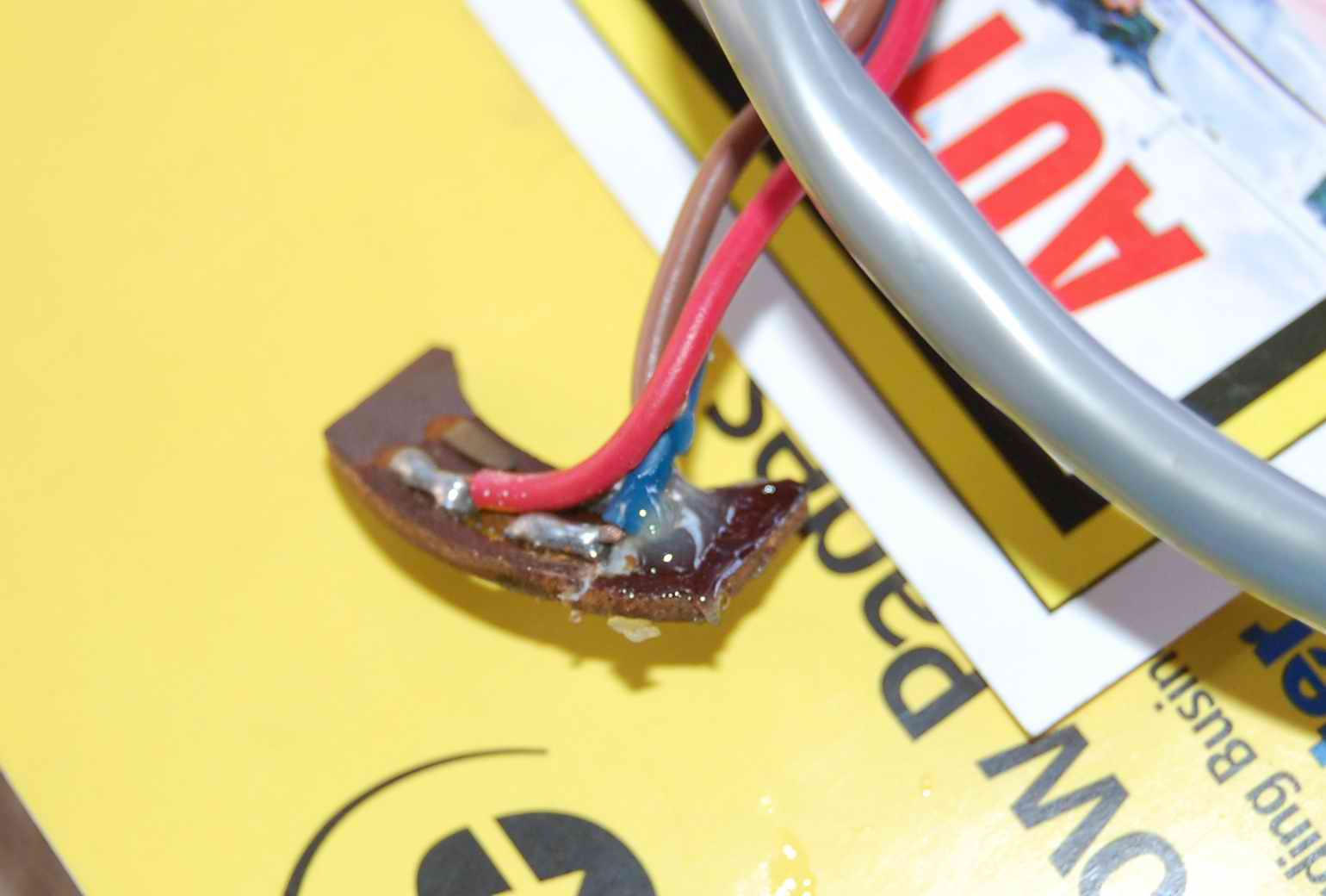

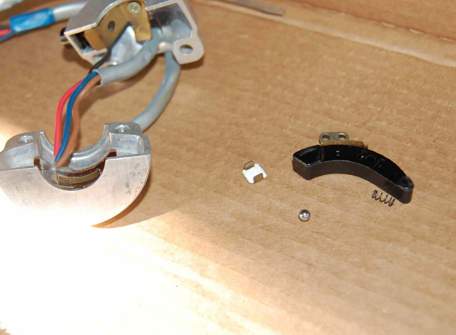

Sounds like you're missing the insulator that goes between #2 (metal three sided piece) and #3 (spring) in your description. I had same problem, LM straightened me out and gave me the insulator I needed. Stubborn guy that I am, I decided to make my own out of one of those fake sample credit cards that come in the mail, which seems to work fine. Just hope my repair on the contactor works. I finally figgered out to put contactor in first, then work the plastic switch crescent (with insulator and brass piece on outside and spring and eventually the ball inside) back into place. Ball goes in at last minute when switch piece is partway down, if that makes sense.

jleeweb, thanks a million for posting those pictures. I was going to half joke earlier about how it would be nice if one of you guys could take apart your switch and send me some pictures but you've gone and done it. Much appreciated. The H-shaped insulator is something not present in my switch, so it looks like I have a decision to make...start helping the economy by spending the hell out that credit card I got in the mail yesterday or use it to make a motorcycle part. I'm torn between patriotism and wrenchin'. Holding all those tiny parts just right while attempting to get them back into the switch is a pretty fun deal. Kind of like building a ship in a bottle.

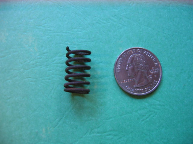

Here's a trivia contest: Can anyone describe what location on my bike is missing the spring shown in the photograph?

What photograph? Or am I being a bit a bit vacant?Here's a trivia contest: Can anyone describe what location on my bike is missing the spring shown in the photograph?
