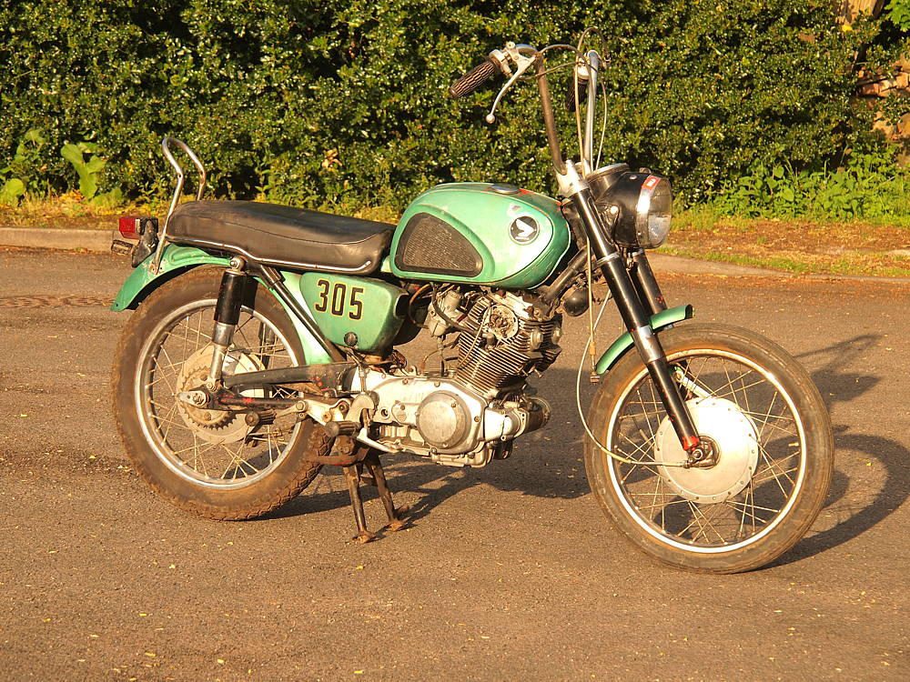

I discovered some photos of the Old Girl taken back when I purchased her in 1971 and then in 1982 when I was back to NY for a visit (I brought her home to California in 1986).
I'm still trying to understand why so many of these bikes had their front fenders cropped by their original owners! As you can see, mine came cropped. I had a friend move the center bracket for me so that the fender at least covered the top of the front wheel. It still looks pretty extreme, though.

Most front fenders were cut back after it was damaged by a collision with something. (ran into something)
Even in the 60's that fender cost over $100.00 used so many were cut short to save $$$$. ...........lm

Wow, that was/is a pricey part, LM! Mine was originally cut exactly at the fork mount bracket, and it looked horrible. It still looks pretty funky, certainly not "original". I plan to ask one of the sheet metal guys where I work if he can fabricate an affordable extension and weld (or braze) it to the front of my existing fender. I've thought, too, if I could find a another cut fender, I could have the two welded together to make a "proper" front fender.LOUD MOUSE wrote:Most front fenders were cut back after it was damaged by a collision with something. (ran into something)
