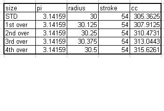

Displacement equals (number of cylinders) * pi * bore radius squared * stroke all divided by 1000 to convert from mm cubed to cm cubed. The table below has displacements based on oversizes. Not sure if this is perfectly exact, but it should be close. See attached picture for table.
Example ( 2 (cylinders) * 3.14159 * 30(mm bore radius)^2 * 54(mm stoke) ) / 1000 (mm cubed per cc) = 305.4 cc's.
Good times with math...
A better question is what is your compression ratio. This is cylinder volume at BDC divided by combustion chamber volume at TDC. Supposedly a CB72 head correctly chamfered on a CB77 lower end is higher compression than a CB77 head on a CB77 bottom end.
Anyone?
Anyone?
