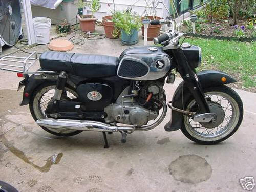

Hello all actually looks like I am going to pick up my first classic bike. 66 Dream in nice shape in black. Been a few years since I road but its just like riding a bike you never forget. All the down for 1st right? LOL
I have seen on the site so far some pics of Superhawks and Dreams do we have a section or archive that can explain the differences between a CA77 and CB77. Maybe I am not learned as of yet to see the differences between the two. Unless I am looking at the same pics?
I tried a few different wordings in search fields but to no avail.
Again looking forward to learning alot about this bike. I think they the dream is very cool looking especially the white wall tires. I know its no speed demon. I am hoping me and my wife can enjoy riding it together.

The picture you posted is indeed a CA77. It has a steel stamped, and welded frame. One carb, a 360 crank ( both pistons up and down at the same time), leading link type fork, 16" wheels, etc.
The CB72/77Superhawk has a steel tubular frame, two carbs, a 180 crank, conventional tube slider fork, 18" wheels, and a few more things.

The CL72/77 Scrambler had a full steel tubular frame, no electric start, a 180 crank, ( I think a 360 in some of the later ones), slider forks, 19" wheels, high pipe exhaust out one side and a few more things to make it more Scrambler-ish.
