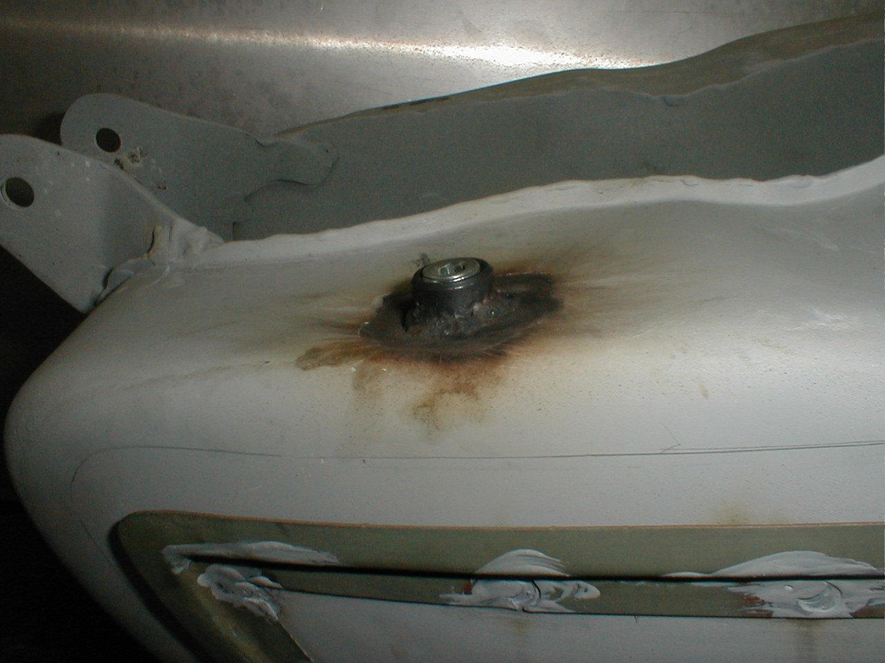

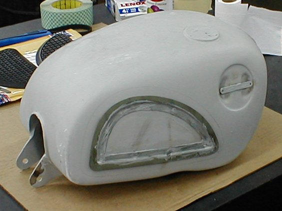

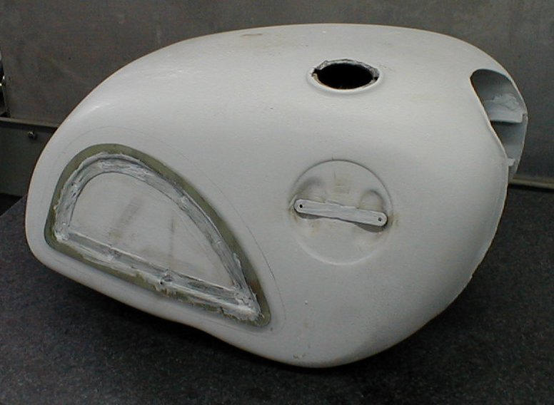

With that said, I cut the knee pad brackets off the junk tank and stripped the good tank. Several dents were repaired and the good tank sprayed with primer. I layed the rubber knee pads on each side of the tank and traced them with a lead pencil and then aligned the brackets to where they were centered with the pencil outlines. I MIG welded the brackets to the tank using the holes in the brackets where the spotweld cutter was used. I had to fabricate badge brackets and plug welded them also.
I also found that the crossover tube for the reserve side was completely clogged up. This proved to be a blessing as I was concerned that the still to be applied tank sealant would clog the tube up anyway. I cut the elbow off the tank and welded a 1/8" NPT half coupling to the tank where the tube used to be.
Now I have a straight hole in the tank that I can plug while it's being sealed and I will eventually use a 90° brass fitting to replace the original elbow. (Total cost: $6.00) Photos below show the tank with the brackets welded and the half coupling welded to the bottom.

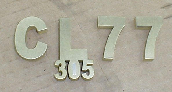

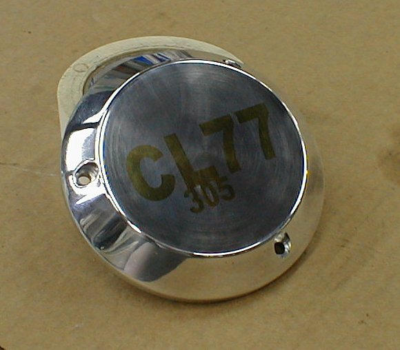

Two items I needed to either obtain or replace were a chain guard and a good dyno cover. My original chain guard was missing from the bike when I purchased it in 1972 and the original dyno cover had been welded several times and would never clean up to my satisfaction.
Being a tool maker and machinist by trade, I decided to make both. The dyno cover is machined from billet 6061-T6 aluminum and EDMed for the brass inserts you can see in the below photos.
The chain guard has been lasered out of .045 thick 304 stainless sheet and then formed and welded. The non welded, tacked and welded stages can be seen below. I now need to fabricate the mounting brackets and glass bead for a satin finish. The script was also EDMed into the guard.
