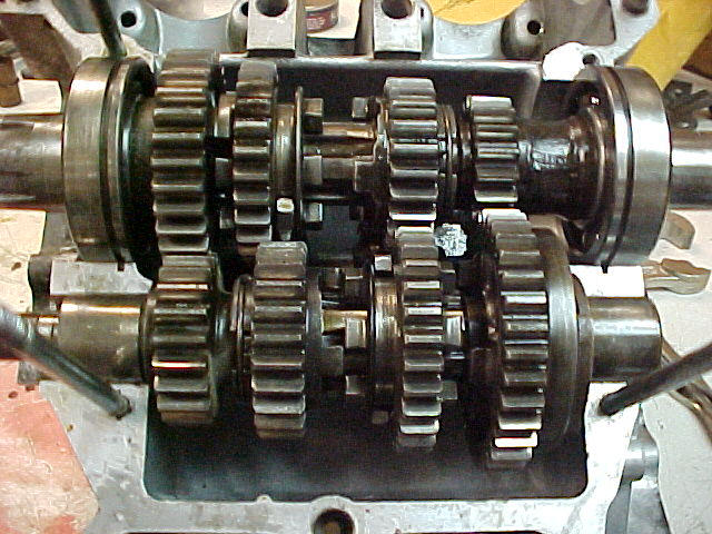

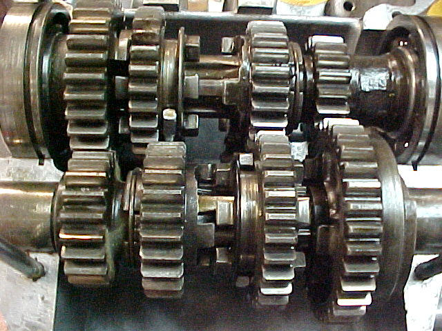

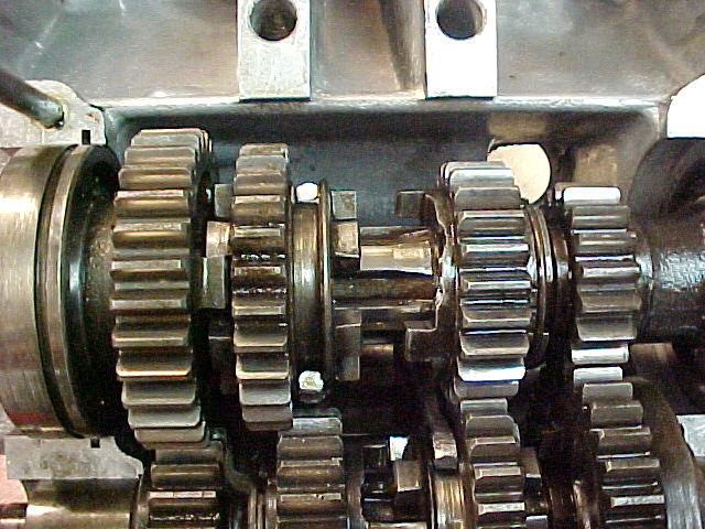

Post by davomoto » Mon Jun 25, 2007 8:55 pm
I too had the exact same problem. I changed the kick shaft, and it got a little better, but wouldn't shift properly. It turned out that I had the gear on the countershaft that the shift fork slides into on backwards. Her's some pics of how the tranny should look when properly assembled. Hope this helps, or perhaps you've already soved the problem?

Post by greg78gs750 » Fri Mar 12, 2010 10:49 pm
this is an old thread, but i wanna say thank you! i was reassembling my transmission and COULD NOT get the gears to shift right. found this thread and found i had a gear in backwards. all is now well! thanks for posting the photos, guys!!
incidentally, either i had a lot of trouble interpreting it, or my parts diagram showing the transmission is wrong! it has the 3rd gear on the main shaft facing the wrong way!
thanks again davomoto!!!
