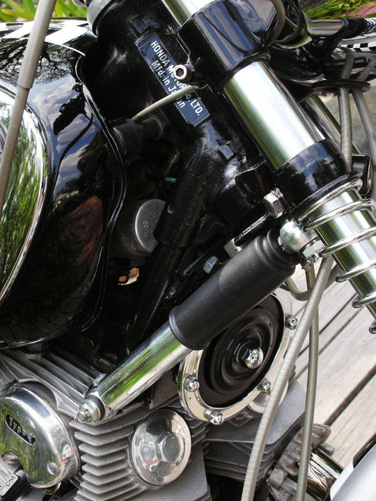

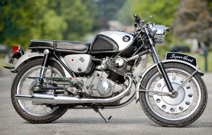

Success with the steering damper! John Grainger - the mechanical whiz kid - worked his magic with the installation, and it looks great. As well, he managed to fabricate the stud for the lower triple tree, so no problems there. As well, we upgraded the headlight to a unit with a replaceable H4 35/35w bulb.
Happy days!

A full shot of it with the steering damper.

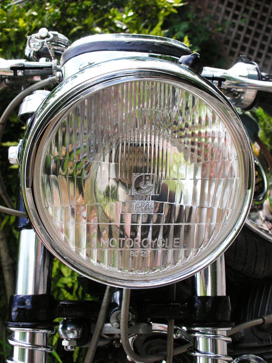

Hello Vince,
The bike is looking great. I think you've done a super nice job with it, even if it isn't quite my style. We all have our quirks, right?
I was just wondering what was involved in the headlight conversion, whether it was simply a new connector spliced into the harness, or whether more work was involved.
Also how much more (in %) would you estimate light output to be now?
-Chris

Hi Chris - thanks for your compliments. I'm sure the bike will look a bit different in a few months - it's always that way with a custom, isn't it?!
As far as the headlight conversion goes, it's a straight plug-in. Well, let me clarify that: some of the sealed beam units use the bullet plugs that are wired right to the headlight. Others, such as those made by 'DIXIE', have three prongs in the back along with the plug that you connect to the bullet plugs in the headlight bucket. So, you need to get that plug first. Then, the actual bulb that comes with this headlight kit is a 60/55w, which is too much for our charging systems. So then you need to get a 35/35w 'low wattage bulb', which is available from Scooterworks in Chicago for about $13.00. The headlight conversion is available from www.cycleseductions.com . Look for the one that is 162mm in size.
I should also mention that the front lens itself is flat, as opposed to curved like 'stock' sealed beam units. I actually prefer the flat glass - looks really vintage!
As far as brightness goes, it seems brighter to me (particularly the high beam), as I think that the low beam wattage for a sealed beam unit is only 25w. And, I don't think it's going to unduly tax the charging system. Funny though - and I don't know if it's connected to this changeoover in any way - but my horn now seems louder...might just be my imagination.
The extremely nice thing about this system is that if you're on a road trip and your bulb burns out, you don't have to worry about tracking a sealed beam unit down - you could even get by with an H4 bulb from Pep Boys just to get you home. Plus, you can carry it in your pocket or tank bag.
Only one thing about the headlight that Cycle Seductions sells - it's meant for a CB400f, so there's all this extra bracketry on the back of the unit that you don't need, so you'll probably have to remove them (not a big deal). As well, you might want to get a few extra headlight retaining spring clips just to be safe (but I don't think it will move around anyways with just the three clips that are already used in the headlight ring).
Hope this info helps....
