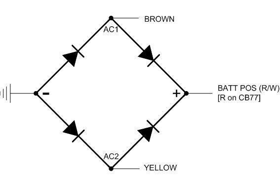

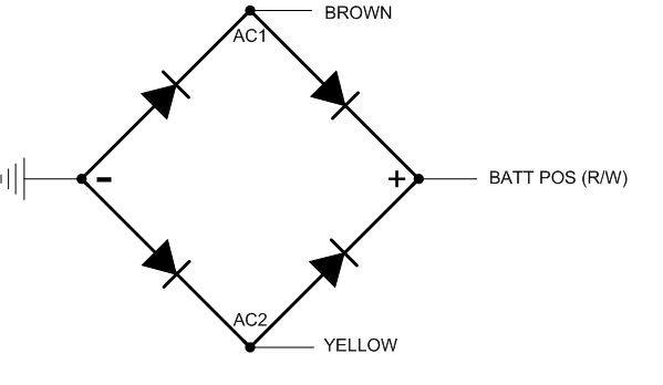

Post by e3steve » Sun Jul 29, 2007 5:23 pm
First disconnect the red (red/wht on C72/77), brown & yellow from the rectifier, as it's not possible to successfully test components whilst in circuit.
With a multimeter, self-powered test lamp or self-powered piezo buzzer, carry out the following tests:
Ready? phasers on stun...sorry multimeter on diode test (or 'beep')
1: probe AC1 (brn) with neg lead and + with pos lead, result should be a short beep
2: reversing probes should result in silence
3: probe AC2 (yel) with neg lead and + with pos lead, result should be a short beep
4: reversing probes should result in silence
5: probe - (gnd) with neg lead and AC1 with pos lead, result should be a short beep
6: reversing probes should result in silence
7: probe - (gnd) with neg lead and AC2 with pos lead, result should be a short beep
8: reversing probes should result in silence
All a diode really is is an electrical non-return valve; positive flow is from anode to cathode (as with all DC circuits), or in the direction of the 'arrow' - this is known as forward current; conversely, negative can be understood to 'flow' in the opposite direction - this is known as reverse current. So think of your multimeter probes (meter on beep) as pos (r) & neg (bk). A good diode will allow forward current (hence the short beep), but will block DC in reverse. A duff diode will either block in both directions or allow flow in both directions. It only takes one diode in a rectifier to mess up the flow sufficiently to reduce the charge dramatically or negate it completely.
I'm open to Qs.

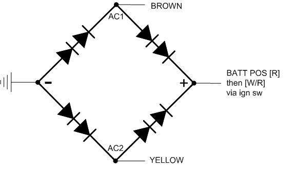

Hey joewier1, essentially no. The rectifier just straightens out the curvy bits, turning ACV into DCV in order to charge the battery. There appears to be no regulator on these systems, which is odd, so I can only assume, at this point, that there is some form of regulation within the rectifier itself. The CB wiring shows 2 diodes per leg, but they are just that - diodes, not zener diodes (which DO offer a crude form of regulation called 'shunting', whereby excess voltage above the zener's threshold is wasted by being turned into heat). I'm looking into it to see how we might improve the charging efficiency.
Incidentally, selenium rectifiers (Honda's technical writer wrote them in as 'celenium', so I've continued that spelling to offset confusion - we should start spelling in English really, instead of Japlish) are notoriously unreliable owing to the heat they produce causing the selenium film to break down and short out. This leads me to believe that back in the early 60s this crude method of 'regulation' was considered sufficient, as opposed to efficient! I suspect that the heat loss is the regulation on these otherwise-brilliant bikes.

Ah, now I've got it! But it doesn't add up; unless the alternator coils are wound and placed in exactly the same orientation on the stator. Yes, of course, that's making sense now. The coils are concentric & side by side on the stator and not 180º removed from each other. This means the alternator IS a dynamo. And I thought it was just the Japlish translation-loss! The additional AC voltage gets added to the rectifier input, increasing the current available at the battery terminals and compensating the system for the extra load. I don't have a working HL or combo switch to hand, so this info is invaluable. Thanks again for all input here.
I'm still unsure why, on the wiring diagrams, the rectifiers differ.
