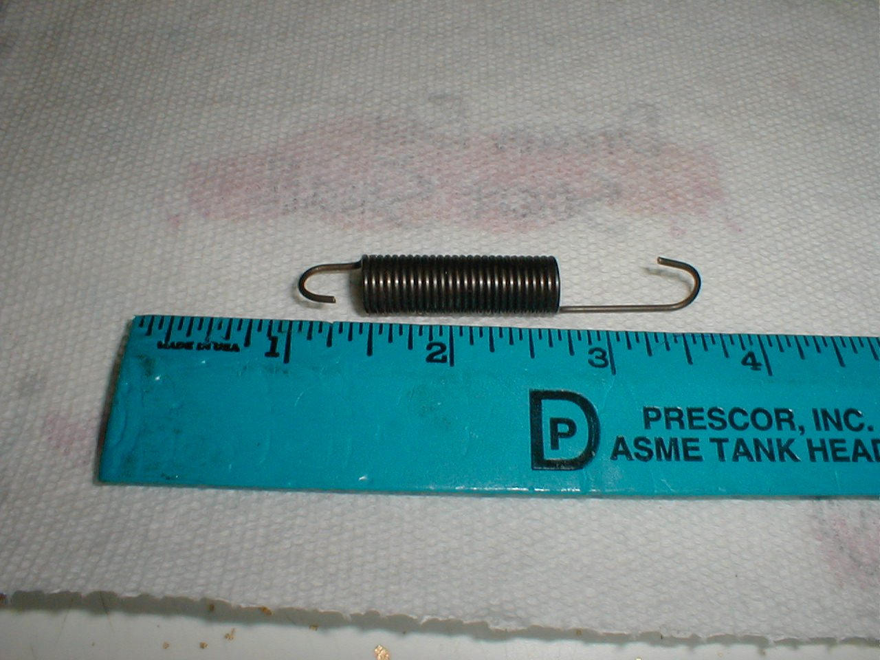

While replacing worn out items on my 1965 CL77, I purchased a new clutch lever spring, PN 22815- 259-010. It's the one that fits inside the RH case and attaches to the clutch lifter thread and, I am presuming, the small hole in the inner case rib.
Although it looks to be the correct spring when compared to all illustrations I can find. It looks to be too long as the spring barely begins to pull when the lifter thread is at it's highest point (Clutch fully engaged).
Attached is a photo of the spring I received from Ohio Cycle for PN 22815-259-010.
Does this look to be the correct spring?
The one I took off the bike was shorter and began to exert spring tension with the first movement of the thread, although it was obviously not an OEM spring. I replaced it due to wear in one of the eyes.
Any idea why it's fitting, or not fitting as It would appear to need to????
Any advice would be appreciated.
Thanks,
Gary

Post by LOUD MOUSE » Thu Aug 23, 2007 4:58 am
Not even close. Much to long. If the coils are the same length ya can bend the long end to fit the distance required. ........lm

Post by ggray » Fri Aug 24, 2007 10:56 pm
Thanks Ed, It didn't look right to me, now I know.
Gary
