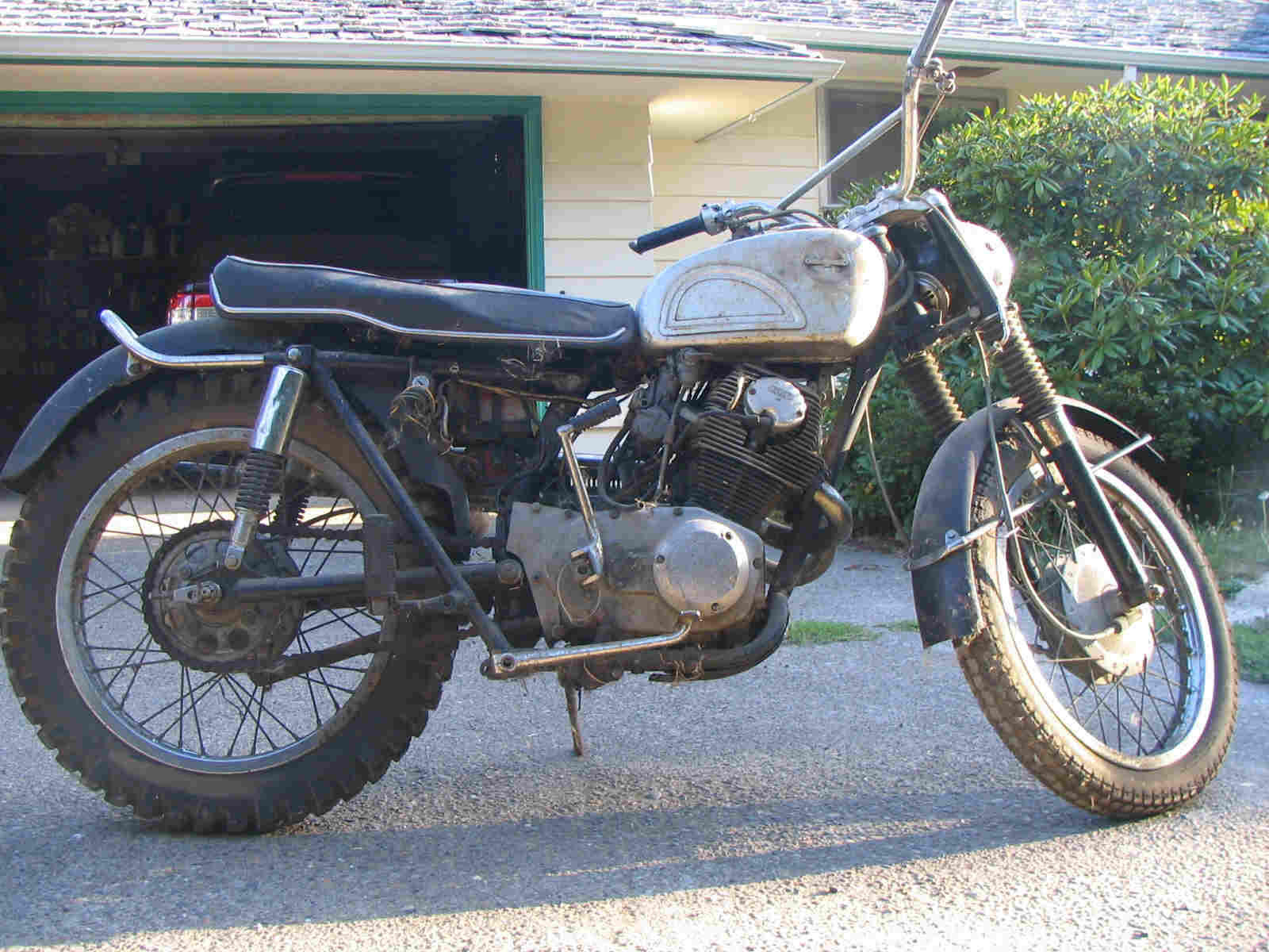

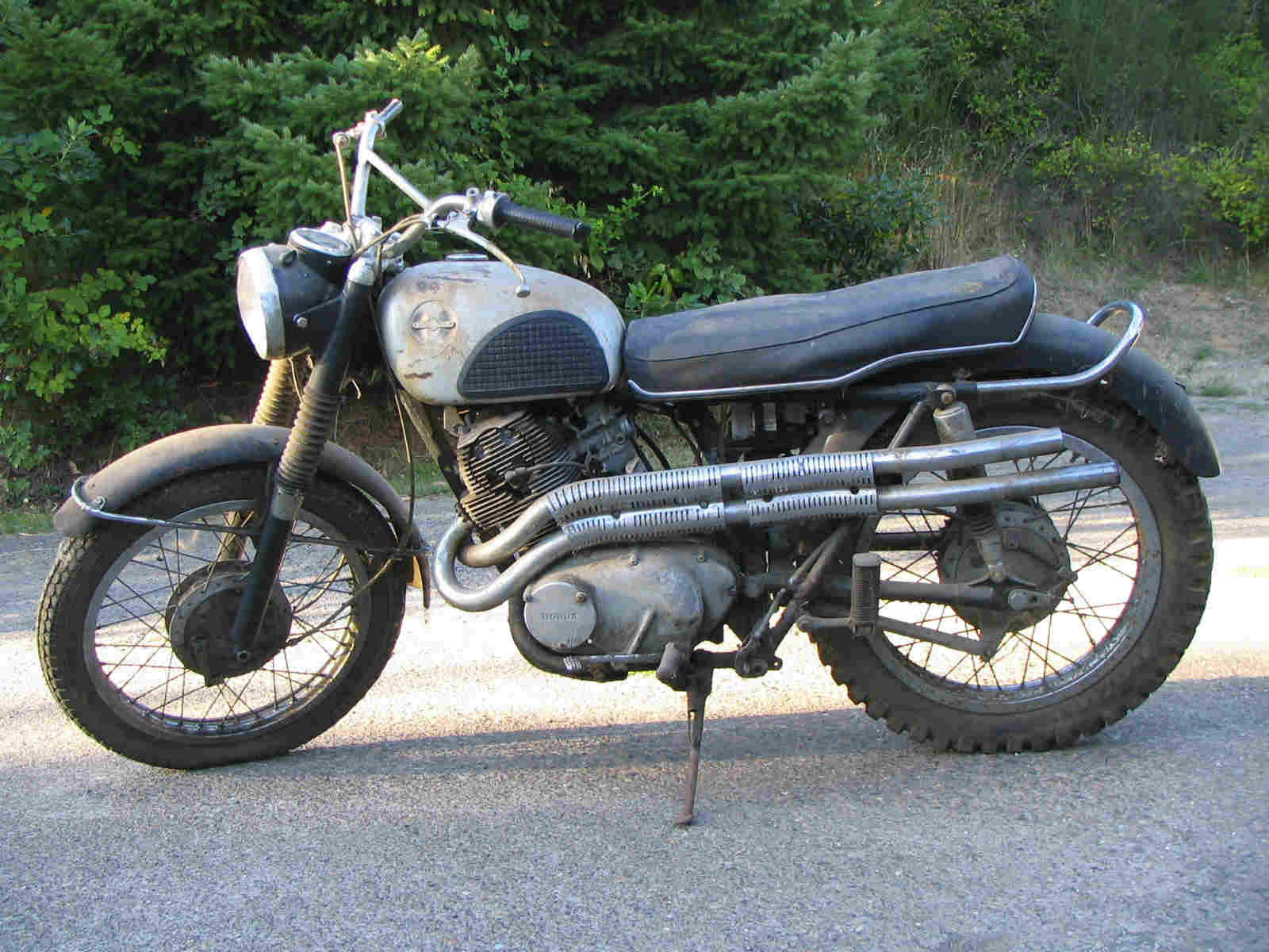

Post by stevej » Wed Aug 29, 2007 10:29 pm
Checked the S/N's
Motor - CL77E-1008215
Frame - CL72316811
I assume that someone transplanted a 305 into a 250 frame and the title is messed up.
Tough to tell from the pictures but it appears to have stock handle bars and stock clutch lever. Seat cover is original with a couple of ripped spots. Front fender, fender bracket, fork boots are all very good outside of paint. To me it does not look like it has ever been laid over.
Has a single arm front brake/hub and the shocks look different from stock unless they are unique to the 250 frame
Still in the discovery phase and once again thanks for the help

Post by LOUD MOUSE » Thu Aug 30, 2007 8:19 am
All the parts of this bike are for the Small Brake CL77. I don't see any 250 parts anywhere. As for your shocks they have the bottom chrome spring cover on the top and the painted top is missing.
My guess is that the original frame was damaged and the owner at that time bought a 1963 CL72 frame and replaced the damaged one. Very common back then.
